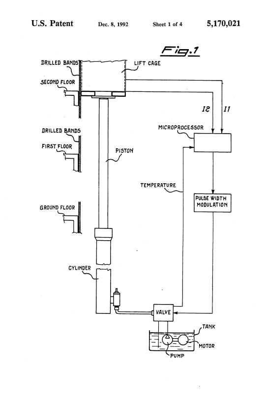

The only pressure that would be on the system is what was used to get the cab to the position it was suspended at then the shutoff valve closed. There is seven 90 degree joints in the system on 2.5" piping.
This is a generic layout.
Example of the style pump/valve system.

do you have a hydraulic circuit/schematic?
