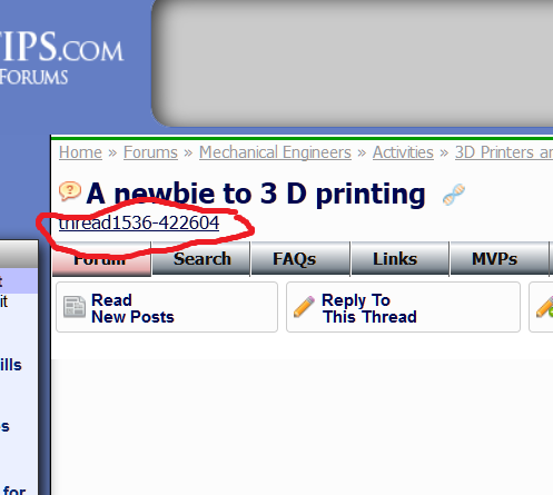

Hi JNieman; Next time please just paste this:
Just directly copy paste the threäd1536-422604 Instead of the informationless URL as it results in this more useful result instead:
thread1536-422604: A newbie to 3 D printing
