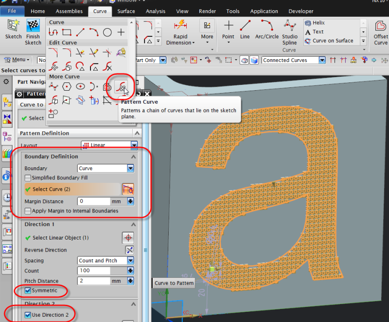

Make sketch with outer shape.
Inside boundaries make small circle.
go to patter featre, select small circle as feature to pattern.
In pattern definition, expand BOUNDARY DEFINITION, and select curves of sketch of big shape.
Specify vectors for pattern, and count and pitch that will cover big form.
Click OK.

You will find a similar option under the Pattern Curve INSIDE the sketcher, IF (!) you toggle OFF the "Create Inferred Constraints" first.
Note that it will not be associative/Parametric.
