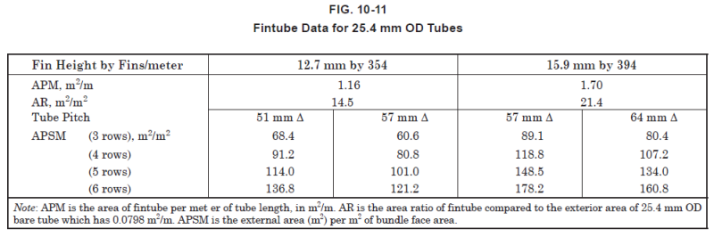

GPSA Databook quotes two types of fin height/fin density per meter, for 1" tubes: 12.7 mm by 354 and 15.9 mm by 394. Your device appears to be of the second type.

Thanks for your answer ,through this data how may i know that fin thickness of 0.4mm is acceptable or not compare to our design fin thickness of range 0.2-0.3mm??

How can we possibly know whether a thicker fin is acceptable to your heat exchanger design? What is the traceability of your design requirements? What does the engineer who came up with these requirements say? What does the supplier say about how much better or worse is the heat exchange?

Fin thickness 0.4mm (0.016") is standard size for many air cooler suppliers - to name a few: Hudson, Harsco/Hammco, Thermal etc. If you are asking if it is OK to have 0.4mm fin thickness, the answer is yes.
