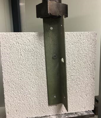

There has been independant testing that has determined the shear capacity of screws in reinforced AAC panels. The recorded results included characteristic values at both the initial shear slip as well as ultimate shear failure.
For the purpose of my calculations, I was only going to use the initial slip values to ensure a conservative design.

Unfortunately as this assessment has been completed using a specific brand of AAC I cannot disclose any documentation at this stage unless approved by the document owners.
Initial testing was completed using AAC screwed into timber, however as it was quickly determined that the AAC panels governed the design; the rig setup was changed to eliminate another variable in the testing.
The testing rig setup was updated to using a steel angle connected to a hydraulic ram which had a screw passing through the angle and into the AAC panels. The ram would then be loaded which produced a shearforce vs deflection curve. Hence we could obtain initial shear-slip and ultimate shear capacity.
