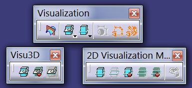

Hello I need to change the color of dimension on sketch. I'm working with some green surfaces in the back, and I can't see them. I can't change the color of those surfaces, request from my client.

RE: change sketch dimension color
Another option is to change the background with the Visualization tools in Sketcher:
maybe No Background, or Underintensify Background
