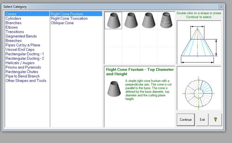

there's is a software called plate n sheet which is used for this job .. I wanna learn the manual method please >

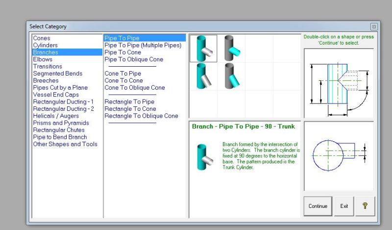

my question was about the intersection of pipes in fittings >> e.g if i want to make a 10 inches branch in a 16 inches header with 45 degree .. how to cut the pipes to make perfect mesh between the two pipes
this method is about dividing the perimeter of the pipes into segment and then do some calculations .
i want to learn this method

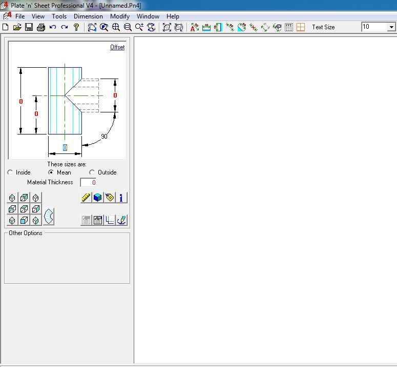

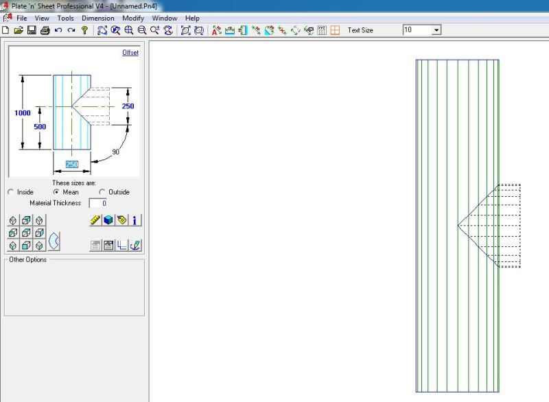

Dear chicopee .. i guess i wasn't that good in showing my point .. to fully get my point use the ( Plate n Sheet ) software .. it's a very small program .. i just wanna do what it does manually .. thanks alot sir
