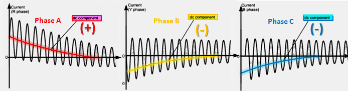

Question 4: Why does the Idc component have negative sign? Response 4: No necessary the Idc component is negative. For a three phase fault, see the graph below with Idc components negative and positive as well.
