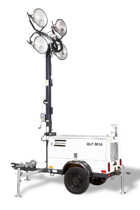

I use a 6 KW Light Tower for back-up for my home.
Electric stove, freezer, refrigerator, deep well pump, sewage pump, Microwave, toaster, forced air fans on two furnaces.
We don't use the electric clothes drier on the generator.
During times when we have grid power we also use the tower lights for night time skating in the winter.
We occasionally trip the main breaker.
By far the most fuel is used to keep the engine running during light loading or no loading.
I would rather reset the breaker occasionally than buy the fuel for a larger set.
The trips are always during times of cooking and appliance use.
The load is always lighter at night so we don't have to worry about the set tripping off at night and waking up to a cold house and a cold engine.
