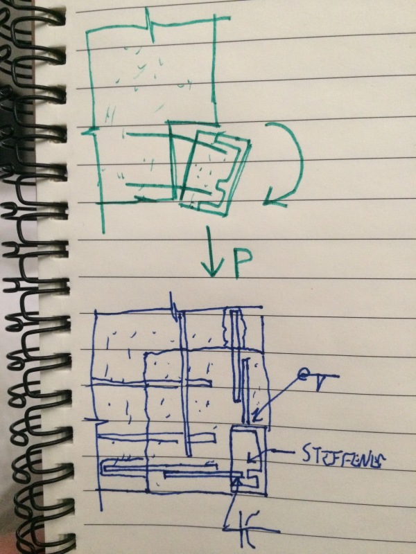

Just a quick introduction, I have found this forum very helpful and interesting since starting my first engineering job this past year, so I decided to register, and this is my first post here. Anyways...
I am looking at a project involving replacing a sluice gate embedded in a concrete wall. The gate is fixed into the wall by attaching to an "E" type thimble, an iron fabrication with three flanges that embed into the wall around the opening. For the replacement, the concrete holding the existing thimble will be cut out, and new concrete will be poured against the existing mass, with the new thimble in place.
I am trying to figure out the needed reinforcement in the area. This seems like a shear friction problem, since new concrete will be poured against existing concrete exposed in the cut. Do the provisions of ACI 318 11.6 apply to this situation? i.e. can I calculate the required area of shear reinforcement as Vn/(fy*mu)? I assume this required area of reinforcing would then just be distributed around the perimeter of the opening in the wall, across the shear plane formed by the line between new and exposed concrete? I also understand that the roughness of the exposed surface, and the angle of reinforcement will impact the calculation.
If anyone has experience with similar situations, or any recommendations on other things to consider regarding the rebar for this situation, it is greatly appreciated.

RE: Shear Reinforcing for Replacement of Sluice Gate
Quote (AThor)
My understanding is that the shear reinforcing would be in tension, creating a normal compression force between the two faces, mobilizing the concrete friction. So the longitudinal reinforcing would be providing an additional AsFy of resistance capacity?
That's one way to think of it. My real concerns with your proposal are two fold:
A1) The method that you've described doesn't give account of the moment that will exist on your new blob of concrete in addition to the shear. You could get that done with the bars that you've shown and, perhaps, that's just another aspect of the design that you haven't tabled here, I don't know. Regardless, it's something that needs addressing.
A2) With your method, I feel that the cracking that I've alluded to in my sketch above (green) is a real possibility. For the sake of durability and permeability, if nothing else, I feel that some reinforcing should cross all of the pour joints.
Quote (AThor)
Let's say, theoretically, you had enough longitudinal anchors, adequately developed, to resist the loads without any shear reinforcing. Would there be any need for shear reinforcing, or do the two serve individual purposes besides just being added security?
I still feel that both are required for the reasons that I listed above. With the longitudinal reinforcing, I think that you've got two nice things working in your favor:
B1) The moment on the blobs are less because the eccentricity between the applied load and the shear resistance (longitudinal bars) is less, perhaps even zero.
B2) Moment can be resisted via concrete compression and shear rather than relying on tension which is less reliable and teds to open up cracks.
Quote (AThor)
Or is it just as SRE said, the more anchoring you can reasonably put in, the better?
While I agree with the sentiment in general, I'd be inclined to express it a bit differently.
C1) No matter how many anchors your use, it still needs to be shown to work by calculation.
C2) I feel that conservatism and redundancy are highly desirable in this situation.
C3) Beyond being conservative and redundant, I wouldn't seek to pound as many anchors in as will fit. Anchor installation damages the existing concrete. Micro cracks and all that jazz. Too many anchors and I'd worry that you'd render your substrate porous and/or too damaged to resist load. The structural refurbishment version of the Hippocratic oath is: be damn sure that you do more good than harm.
I think I should mention that, as a junior engineer, my role on this project currently is taking a preliminary look at the project, and the final detailing we settle on will have input from more experienced engineers. Since this is my first project of this type, I am just trying to gather as much information and input as I can from many sources about general considerations in projects like this. So while I won't be stamping this, as an engineer involved on the project, I need to do my best to understand all relevant considerations.
I appreciate the ideas presented so far and the experience you all have. It seems the consensus (which I agree with), is that conservatism is better on water-retaining structures, due to the potentially catastrophic impacts of failure.
Koot - You raise an important point about the negative impacts of overly dense installation. I can see how cracks are potentially more harmful in concrete hydraulic structures due to the water pressure involved. Again, the Army Corps manual EM 1110-2-2104 that I have been looking at has requirements for bar spacing, development, and detailing etc. It seems like those guidelines would be appropriate to follow? But like SRE said, it will be important to remember that the existing conditions may largely govern what is possible. Do any of you have any other reference documents that might have useful information on this topic?
