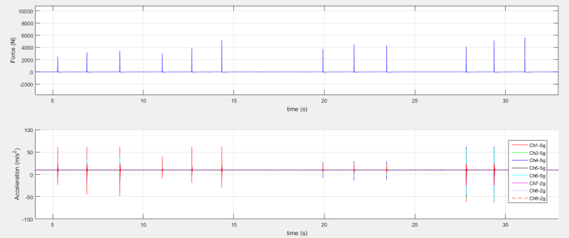

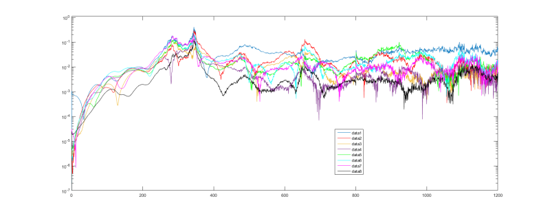

I have attached data I acquired for one sleeper in time. Both force and acceleration are presented.
Fig 1. Force and Acceleration for all impacts and all channels

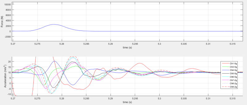

Fig 2. Force and acceleration for impact at sleeper right end side
Fig 3. Force and accleration for impact at sleeper right end side-zoomed in

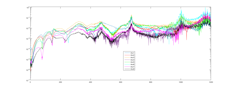

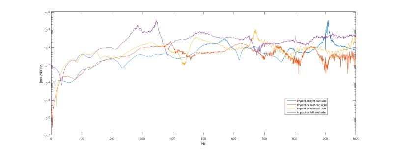

Fig 4. Accelerance functions for channel 1 for impact at sleepers end on the right hand side; top of railhead on the right side, top of railhead on the left side; and sleepers end on the left hand side . Channel 1 is located on the end of the sleeper on the right end side.
Fig 5. Accelerances for all channels when the impact is done on sleepers end at right hand side.

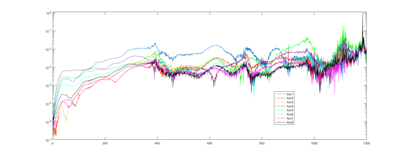

Fig 6. Accelerances for all channels when the impact is done on sleepers end on the left hand side.
Fig 7. Accelerances for all channels when the impact is done on topf of railhead on the left hand side.
Fig 8. Accelerances for all channels when the impact is done on topf of railhead on the right hand side.
I have used +/-2g and +/-5g range MEMS DC accelerometers. Sensitivity for 5g acc was within 394 to 411 mV/g, whereas the sensitivity of 5g acc was within 998 to 1016 mV/g.
The impact hammer is PCB 086D50 with 5,5kg and soft tip.
The 2g acc were overranged when the impact location was in their vicinity. The impacts were done at both sleepers end and on top of the rail head at both rail seats. So in total I had 4 groups of impacts and within every group 3 hammer impacts are done.

As a casual observer, my guess is the soft tip provides excitation at only the low frequencies (<300Hz?). That may explain why the response higher frequencies are 'noisier' compared to the lower frequencies for all channels. This is effectively a physical low pass filter. A way to confirm this is to plot the autopower spectrum of the hammer. If the above is true, try switching to a harder tip.

You need to compute Coherence Function, if you have not done it yet to check data quality. What color hammer tip did you use? A soft tip like the Gray color is only good for about 200-Hz F-max or less. What modes/frequencies are you interested in? Are you triggering measurements on Force. If yes, then you should only have one impact per time window. MEMS accelerometers do not have wide dynamic range as conventional ICP/IEPE piezoelectric accelerometers.

If I can read your timescale correctly the pulse for the force is about 0.01 seconds long, so the cutoff for the force input will be 100 Hz or so. Other than that the results don't look too bad.
I'd always include the phase plots and coherence
Also try checking the reciprocity, and try the effect of different force levels.

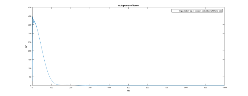

Quote (As a casual observer, my guess is the soft tip provides excitation at only the low frequencies (<300Hz?). That may explain why the response higher frequencies are 'noisier' compared to the lower frequencies for all channels. This is effectively a physical low pass filter. A way to confirm this is to plot the autopower spectrum of the hammer. If the above is true, try switching to a harder tip.)
This is the autopower spectrum of the force for impact on top of the sleeper

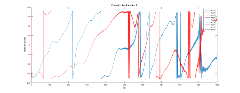

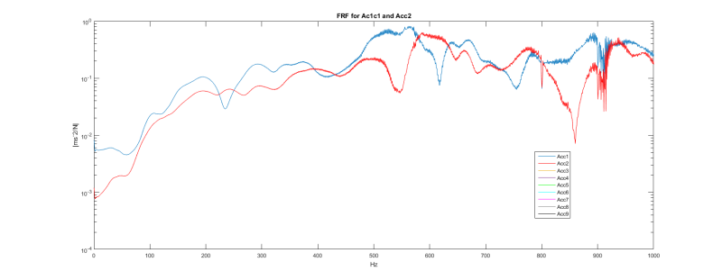

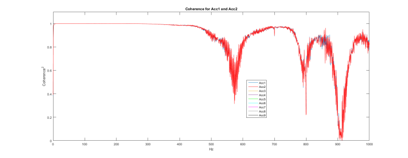

The following figures show FRF, pahse and coherence for two accelerometers and impact on on top of the sleeper. Also, I have plotted coherence^2 for these.

I haven't applied any filters on the force or acceleration data. I applied detrend (by subtracting the mean) to acceleration data to remove the gravity effect. The FRfs I have calculated as cross spectrum
between the force and acceleration, divided by the autospectrum of the force. I used for this cpsd function in Matlab with Pwelch spectra estimate; rectangular window with 50% overlapping;window length = NFFT/4.
Do you think I can proceed further with data analysis, e.g. filtering out the frequencies of interest?

According to the Force spectrum, there is no force input into the structure above 100 Hz. Why would the Coherence be so high and flat to 400-Hz and near 700-Hz? Reciprocity means that the same TF result should occur if you exchange the impact and response locations. Frankly, I would improve the test procedure on an easier structure and use only one accelerometer to get some confidence.

So the response spectrum shows very little energy above 110 Hz and virtually none above 250. You need that line to be flattish over the frequency range of interest. I'd switch to a harder tip.

The auto-power is traditionally shown in the log-y axis similar to transfer function. Maybe that would show it trending down sharply after 300Hz. Do you get something similar to Blue line of Figure 1 of https://www.uml.edu/docs/oct98_tcm18-189815.pdf? Please compute it as described below.

Each impact of the hammer produces vibration that decays within it's own time block. You have 12 hits so there are 12 averages of those blocks. The data in between the time blocks are mostly noise and thus discarded.
