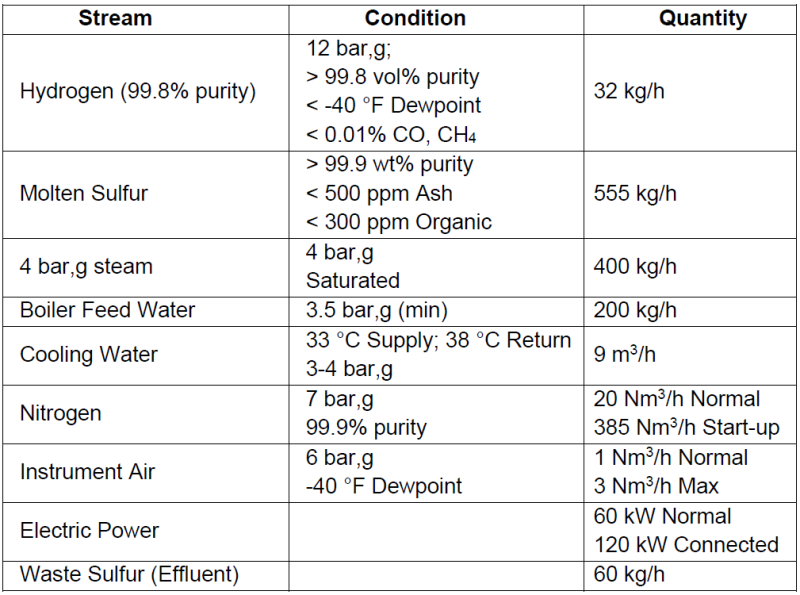

Thank you all for your replies. I was in contact with Uniteltech and got a price estimate. For future reference:
H2S production facility
1. 13 metric ton per day H2S Capacity
2. 98.5 vol% H2S purity (min)
3. 1.5 vol% H2 concentration (max)
4. 5 ppmw S concentration (max)
5. H2S delivery pressure and temperature: 6 bar,g @ 45-50 °C
The estimated cost of the unit (ISBL) is $ 5,500,000 (+25%/-15%); Ex-Works Joliet, IL,
USA.
The cost estimate provided does not include the following:
1. Civil work including site improvements, grading, and foundations. Unitel will provide
foundation load requirements.
2. Utility systems including steam, cooling water, nitrogen, instrument air, boiler feed
water.
3. Waste treatment and disposal systems. A thermal oxidizer or flare system is
required for handling normal and emergency vents.
4. Main sulfur storage tank. Unitel will provide a day tank on the modular unit from
which sulfur will be fed to the reactor. A main sulfur storage tank along with auxiliary
systems is not included.
5. Piping and pipe racks from OSBL systems to the ISBL modular system.
6. Electrical connection from facility MCC to modular system primary power distribution
panel. A single feeder will be required with a capacity on the order of 120 kW (400
V/ 3 ϕ / 50 Hz).
7. Hydrogen supply.
8. Transportation.
9. Taxes and duties of any kind.

Have these guys ever built such a unit before? Did they give a list of references for previous H2S generation projects?

They have built installations in US, Europe and Asia, no list though.
The project is still in concept phase but as Finland only has two oil refineries, the closest is 380 km away.

Just curious if they've ever built a H2S generation facility, anywhere. You'd want to know that...
RE: H2S production
JGC website says 2 units built, one in progress. Not sure for Uniteltech and Bechtel.
Dejan IVANOVIC
Process Engineer, MSChE
RE: H2S production
From the internet, C&I Engineering in Louisville, KY, USA list the H2S generation plant in Western Australia at Murrin Murrin Nickel, Kalgoorlie in their list of projects completed.
RE: H2S production
We completed a feasibility study for the production of H2S for a major fortune 500 company. They were not near a refinery. The conversion of CS2 by hydrolysis is another route.
