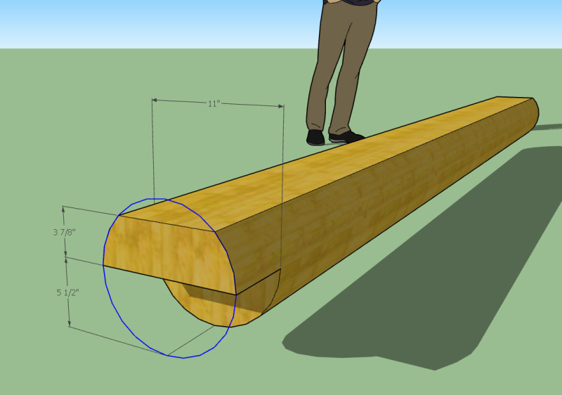

I've never had to run the numbers on a round log beam before. Looking through all of my software that I use for beam calcs I don't think any of them has the ability to check a DF 11" Dia. Log. Any suggestions?

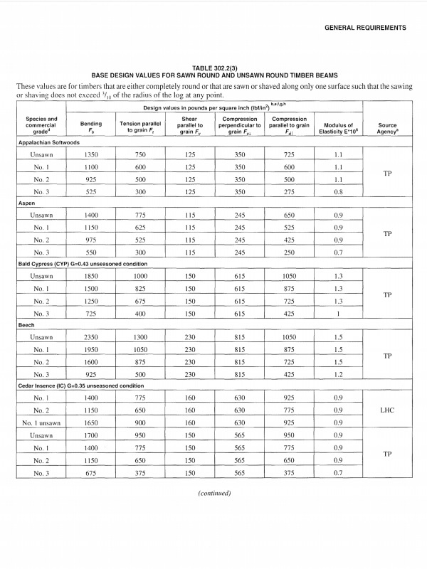

Look up ICC 400-2007. Excerpt below. It's the different grading that might trip you up.

I just remembered I purchased the ICC 400-2012 about 2 years ago, just found it buried beneath a stack of books.
When I compare this standard to the NDS (Ch. 6), the only real difference that I note is that the NDS has a condition treatment factor Cct whereas there is no mention of this in the 400-2012.

Tension side notch? Percentage of depth?
RE: Log Beams
It appears that common practice is to cope the log that is the beam and leave the bearing log mostly un-notched. In some cases the coped log could be notched as much as half the diameter basically leaving a semi-circular cross section at the bearing point.
For a circular cross section the shear stress is 4V/3A, with a semi-circular cross section the other notes I have show a shear stress of approximately double this value, in reality though I think it may be higher due to the oddly shaped cross section and stress concentrations from the cope.

Then there is the SRTB and USRTB. The SRTB can have the compression side sawn off up to 3/10 of the radius of the log. So worst case scenario is a coped log at half the diameter with the full 3/10 sawn off the top for the floor board above, see image below:
