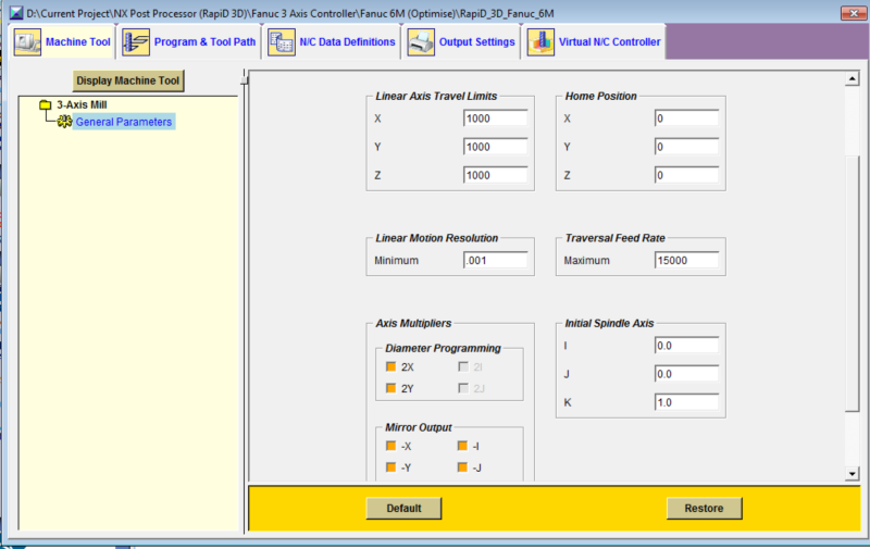

Take a look at opening the post processor in Post Builder. Go to N/C Data Definitions, Format, Coordinate and change the digits there. You can also look at Machine Tool, General Parameters, Linear Motion Resolution. Whether this is the problem and if your machine will accept more digits isn't something I can answer. The Post Builder Help files are helpful.

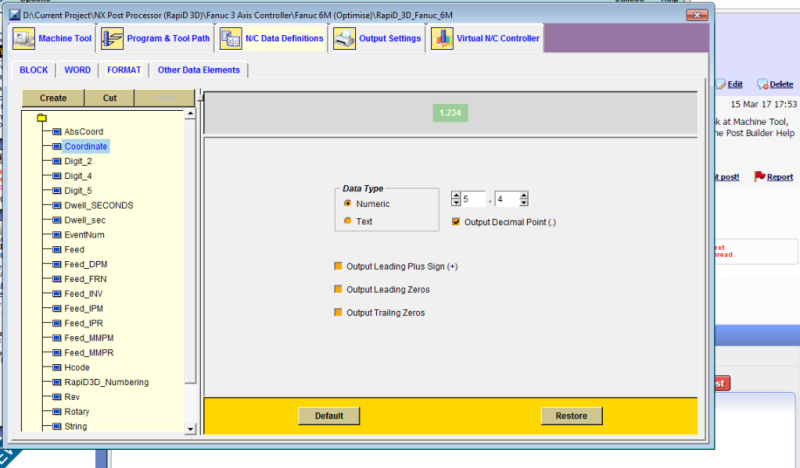

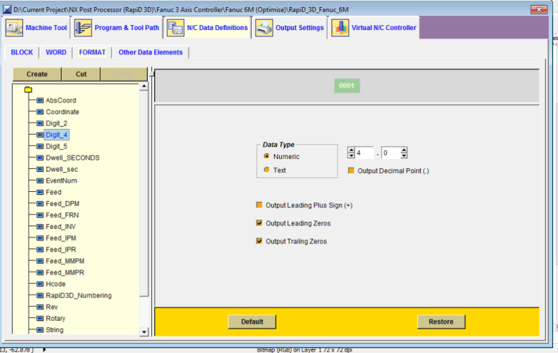

I check the post builder and attached the main setting that you asked to check.
And I change Coordinate decimal place to 4 digit (Previously 3). I attached some images for any correction need to made that you feel and that will great help to me.

Well, I'm not GTAC and don't purport to be an expert, but if it was me, first I'd find the offending spot in the file and check to see if rounding has anything to do with it. If your coordinates are off by less than your precision, then I'd change the digits on the "Coordinate" to 4 and the "Linear Motion Resolution" to .0001". Then test it on the offending job and see if it changed the coordinates. I also recall having a situation where the length and radius were so small it caused trouble. I remember a setting somewhere that set the smallest arc move and anything smaller would switch to linear. I don't remember where that setting is, though. It's been a long time since I've had to mess with all of this.
