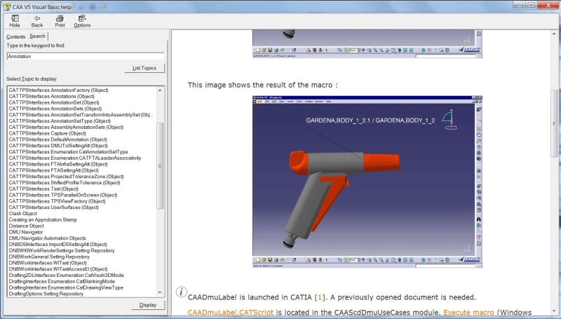

RE: Print file properties and user info on the paper
Hi Ferdo...
According to V5Automation.chm, text can not be added to annotated captures in a CATPart. Your suggestion to search "Annotation" in the V5Automation.chm is for adding text onto a PRODUCT image.
I have tried different ways in both CATPart and CATProduct but can not go any where.
Please kindly verify and let me know.
How can I add/insert below code(quoted from http://www.eng-tips.com/viewthread.cfm?qid=331177) onto annotated captures in an active CATPArt?
Quin,
you should try to find a way to do what you need manualy in CATIA first, then look for code.
when I say you create the text in the capture, you should understand: you create the text as annotation, then bring annotation in capture. I used a shortcut because i assumed you knew a bit about what you wanted to do.
When one have a problem with something, a solution would be to pay for somebody else to do it. Did you think about that?
Eric N.
