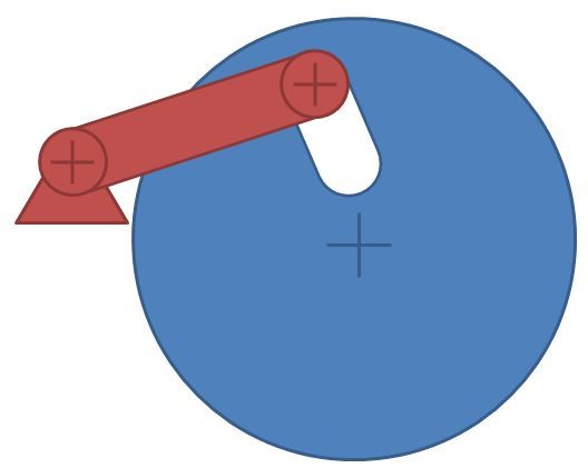

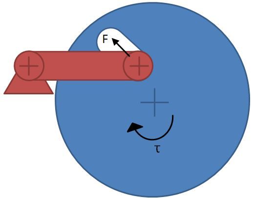

I have a mechanism with a disc that has a slot in it. An arm is connected to the slot with a sliding connection. The arm is held at one end with a fixed pivot position. When the disc rotates the arm can move up and down within the slot and its angular position is related to the angular rotation of the disc. Images are below.
I have two questions that I am struggling with:
1. If I apply a torque to rotate the disc how do I calculate the force that is applied to the arm
2. Is there an optimum design of the slot which maximizes the force transfer (curved, straight, 45° to arm axis etc..)

I'm not sure that your disc and lever will work as drawn, it appears you have a very small angular movement of the disc and I can't see how the disc would drive the link pin to the top of the slot.
RE: Arm and disc mechanism forces
If the follower inside the slot is free sliding or rolling, the force applied to the follower is acting normal to the slot surface, and located at the point of contact.
Also, the reaction force at the fixed pivot will always be directly in line with the arm.
Draw some vectors and do a little trigonometry and you'll be on your way.

It's a cam and follower problem, with a very unfortunate ramp.

1) If you assume both radii big enough, you have a roller forced to climb an inclined plane that slides from left to right. Then, draw a free-body diagram and calculate the forces perpendicular to each radius.
2) Since Work = Torque x Angular velocity, the slot in the disc that produces the biggest torque on the oscillating follower with roller is the one that induces the slowest constant angular velocity of the arm or radial velocity within the disc.

I would draw the kinematic vectors and then inversely solve for the forces.
