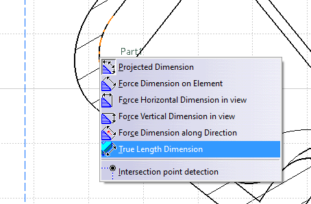

I'm hoping someone could help me figure out how this fillet radius spec was created:
I have a drawing where the fillet in question is not perpendicular to the section line. If I try to attach a regular radius dimension to this fillet, it doesn't get attached correctly. The radius dimension that is already attached in this drawing behaves like a normal radius dimension, except it is purple, which mean "true dimension" in the color scheme that my Catia settings show.
Does anybody have any idea how this purple dimension might have been created?

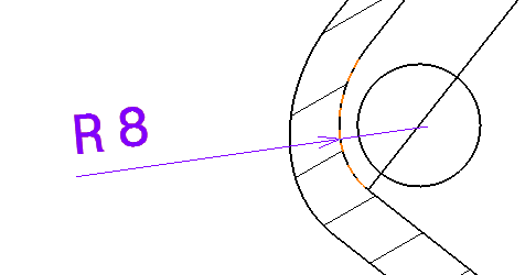

use the true length option in right-click:
I made a circle near the fillet so you can see it is not circular shape on the drawing but real R8 value

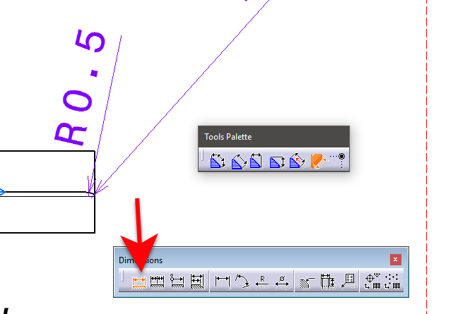

RE: "True dimension" for cross sectioned fillet feature in drawing?
use the regular Dimension tool, not the Radius or Diameter
Eric N.
Could you attach the drawing you've done it in pleade? I still can't do it in the part I uploaded earlier. I'm trying to do it exactly as you've shown.
