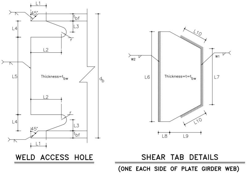

Hi Guys,
Recently our company structural engineers team have designed a high rise steel structure with special moment frames system+ special bracing frames which boosted by rotational friction dampers and used WUF-W connection for connecting beam to column. According to ACI-358-16 (PreQualified steel connections) ,section 2.3.2a Built-up Beams Members, The web and flanges shall be connected using CJP groove welds with a pair of reinforcing fillet welds (min 8mm) within a zone extending from beam end to a distance not less than one beam depth beyond the plastic hinge.
Also according to WUF-W criteria, beams should conform the requirements of Section 2.3., And according to Section 8, the plastic hinge location shall be taken to be at face of the column, So protected Zone is a distance equal depth of the beam at face of the column and in this zone, Welding flange and web of the beam should be CJP+ 8mm (Min) fillet weld in both side of the web.
Our Design was similar to above descriptions completely, Also WPS and Welding Maps of shop drawings prepared true But unfortunately steel manufacturer contractor did not observe these limitations and has connected web and flange just by a 8mm to 12mm fillet weld according to web thickness in both side, therefore there is not any sign of CJP welding.
Now one-fifth of structure has been constructed and erected and we are looking for any criteria for acceptance of as built connections or any other implement works like repairing or retrofitting the connections to satisfy prequalified connections code.
Your prompt answer will be appreciated.

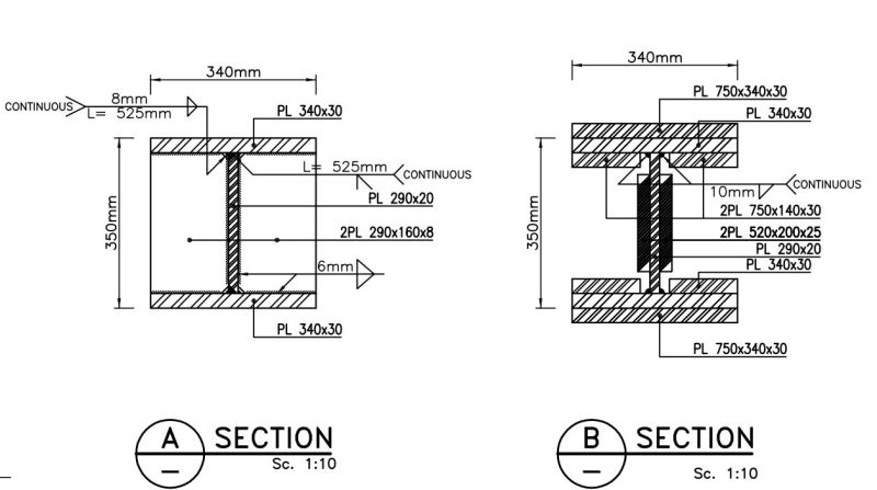

At first i want to explain just a little more about our project.
Our Structural system is special moment frames in two directions and general arrangement of frames is Tube in Tube system with a rigid core in middle.
In external tube , Columns are closely together and we have a column in each 3 meters, so the depth of beams will be limited about one-seventh of clear span of that, Assume that Longitudinal dimension of column is 600mm, So clear span of beam will be 300-60=240mm and total depth of girder will be limited to 240/7 ( Approximately 350 mm).

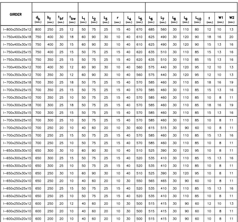

We have wide range of spans and wide range of girder depth too. they have been summarized in following tables :
Also Following detail is general type for our connections and beam splices.
RE: WUF-W Connection
1- The contractor could remove and replace the non-complying members. I recognize that this would be very costly and possibly dangerous. However, this solution would bring you into compliance
2- The contractor could burn off the existing welds, properly prepare the webs for CJP welds, and then complete the CJP weld. I recognize that this would be very costly and possibly dangerous. However, this solution would bring you into compliance
3- Connections in IMF and SMF must be either prequalified or qualified by testing. Requirements are provided in Chapter K of the AISC Seismic Provisions. Though not exactly what was intended, you might choose to “post-qualify” the connections that exist in the structure. This would involve building test subassemblages reflecting the actual conditions and then testing them per Chapter K of the Seismic Provisions. If the tests are successful then the conditions can be left as they are. If not then they will have to be repaired. This option might be a good one for gamblers. The tests will not be cheap (over a decade ago I got an estimate of three tests required per configuration at about $50,000 per test). If the tests work the testing may be cheaper than the repairs. However if they do not work you will have the cost of the tests and the repairs

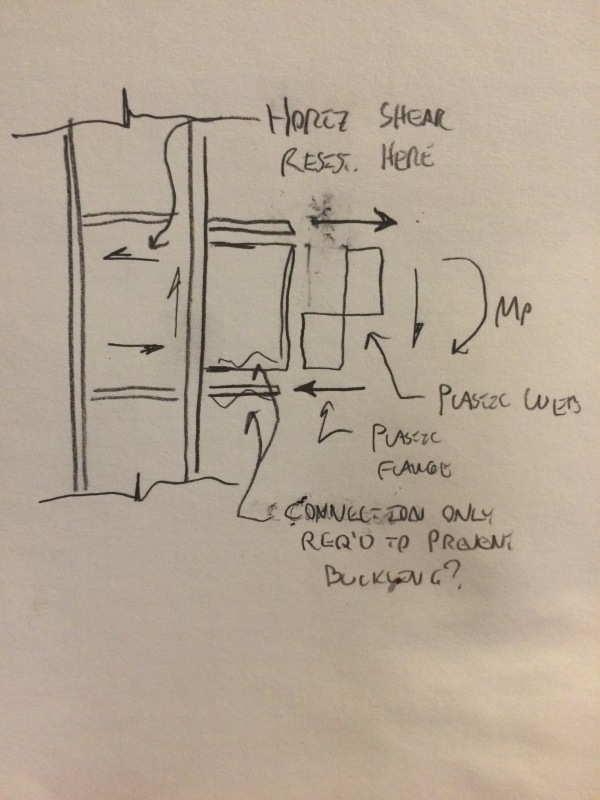

I've been thinking about how one might reinforce this if one were in fact alllowed to reinforce it. You know, first principles. And that got me to wondering: why are these demand critical welds?
At first, I thought that the answer would be obvious. You have to develop the plastic moment so you have to develop reliable horizontal shear transfer to go along with that. But that's not actually true. On the column side of the hinge, 100% of the required horizontal shear capacity is provided by the column panel zone. So there's no problem there.
With respect to important jobs that the welds are doing, all I can come up with is that they prevent the compression flange and web plate edge from buckling. And one would think that would be a relatively easy thing to reinforce for. But, then again, there is that clever engineer hubris problem that I mentioned earlier...

Not so. My sketch and analysis specifically detailed forces associated with plasticity and the web and flange buckling that might occur under cyclic dynamic loading. One can only get so "dynamic" in a quick, 2D, stationary sketch. I get that testing is required for complete understanding and alluded to it twice above myself. I'm trying to dive a little deeper.

No worries, I'm with you on this. Everything in my previous responses assumed and implied cyclic, inelastic behavior.
Firstly, with the right reinforcement scheme, I suspect that you could create a section capable of achieving full plastic section moment over 0.04 radians. That's pretty much what I've been getting at.
Secondly, while I agree that it's necessary to achieve the 0.04 radians, I'm not sure that it's really necessary to achieve the full section plastic moment. All that matters is hitting that level of rotational ductility while maintaining a substantial measure of load resistance. Were the web flexural capacity to be considered sacrificial, you might get some degree of strain softening which is always undesirable. I would argue that the impact would be small and that normal strain hardening would kick in after an initial dip however.
It's important to remember that, in these systems, we're primarily designing for a particular amount of rotational/displacement capacity, not a particular level of load resistance. Consequently, there really is no required load capacity for the welds in this situation other than that expected to arise as a result of rotation. The litmus test for successful performance is simply whether or not the welds remain in tact up to the 0.04 radian displacement so that the web and flanges continue to stabilize one another locally. At least that's my take on it.
If you stabilized the flanges to prevent local buckling, I would argue that you likely would still achieve complete rotation capacity. You might even be able to achieve that rotation at a lower Mp as a result of the web not participating fully which would serve to increase the safety margins on the member of your system designed for capacity/over strength.
With this situation, I feel that the following is likely true:
1) You won't be able to negotiate any further with the AISC 358 committee. You'll simply have to do as they've instructed already. As such, I wouldn't waste too much time trying to argue your way into a lower cost solution.
2) My, very strong, gut feel is that you've got a great system here and that the code deficient welding really does not compromise that. Another thing that you've got going for you here is that the entire perimeter of your building is moment frame rather than just having a few isolated moment frames. And you've got the rigid core. That means a lot of redundancy so, if a handful of welds did give way AND that materially affected the performance in a few of those failures, would that really be such a big deal? I would argue not.
3) The cost of the remedy, per the AISC 358 committee, will be enormous. As the engineer of record, I would consider it my duty to the client, and society at large, to at least make a modest attempt at selling the AHJ on a non-tested reinforcement fix. That, even acknowledging that your odds of success would be extremely low.
4) The only way that you'll have a fighting change of being successful with #3 is if you're able to tell a good story about why the system is fine as is. A story that speaks to the fundamentals of the behavior that the code provisions are intended to encourage. I'm trying to help you come up with that good story.

1) The particular girder detail shown has 30mm thick flanges, which are slightly thicker than the 1" limitation in AISC-358. Also, the clear span-to-depth ratio (2400mm/350mm = 6.86) appears to be slightly lower than the minimum ratio of 7 allowed for SMF. In practice, are these slightly out-of-spec values acceptable for prequalification?
2) NERHP Tech. Brief No. 2 seems to discourage the use of deeper column sections: "deep wide flange
sections, particularly those with lighter weights, are susceptible to undesirable local and lateral-torsional
buckling. The performance of deep column sections is the subject of ongoing research". Wouldn't the skewed connection in this design exacerbate the likelihood of LTB? Can LTB be confidently resisted by lateral column bracing or is that one of the issues that future research will address? Is there any allowance for prequalified connections to be slightly skewed?
