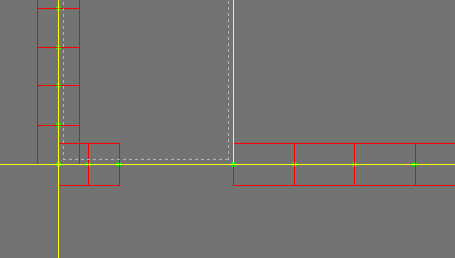

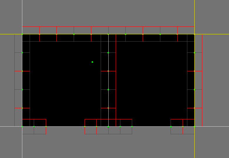

I would like to know your views about the coupling beam design and coupling shear wall connection.
i am having a stair core as shown below screenshot.
Do you think a coupling beam between two walls as shown in the images are good?
I believe that since the walls are out of planes, coupling between these walls are not a good idea. Do you agree or not ?
(However i have to provide a beam to support the slabs. And it can be as deep as 1200mm).
Is openings / Sleeves are allowed to provide in the coupling beams ? If yes , where is the ideal location and approximate allowable sizes ?

I'd use the coupling beams but treat them as though they cantilever from CW5. That will make for some delicate detailing at the free ends of the cantilevers. I think that the best location for penetrations would be midheight of the beams at either end of the beams. Top centre and bottom centre would be my next choices. Essentially, you're trying to avoid the diagonal compression struts that will form in the beams.

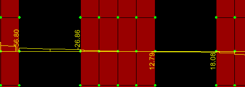

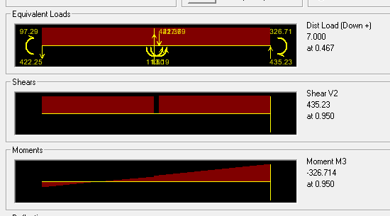

Let me show you a example, this is a central core of a 12 story building, PGA 0.30g:
Now this are the bending moments in the bottom RC coupled beams from E-V earthquake attack:
As you can see there are almost none bending moment.
Now in the same building lets look at this:
These are 2 isolated walls with RC coupled beam in the same direction as the one above.
As you can see is a big difference between 20 and 350 kNm bending moment.
Try it for youself in your case and tell us what you found out.
