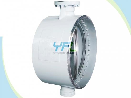

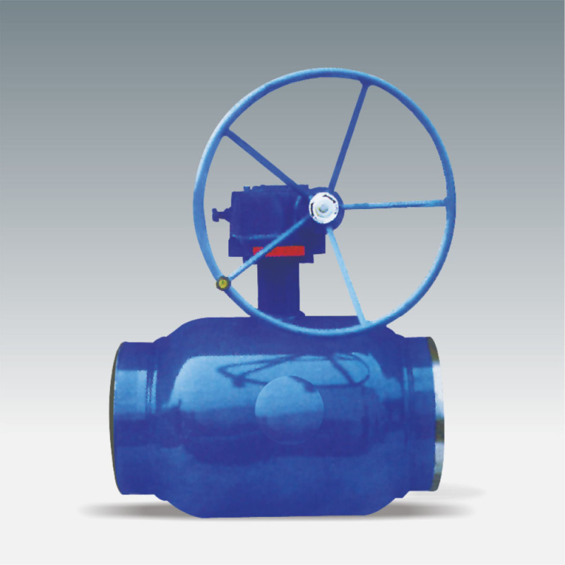

Dear All,
I want to know why use the welded steel ball valve and butterfly valves in the district heating system? What's the advantage?

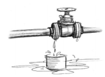

The idea of using welded ends valve is usually to minimize leakage path of the medium.
Sketch courtesy of danfoss
Imagine if the network have several heating leakage point, then it will be an energy loss.

Why ball and butterfly? common practice and process related.

Hi, Like you said, What's the difference between fully welded pipeline ball valve and district heating ball valve?

Hi Janie,
http://heating.danfoss.com/pcmfiles/1/master/other...
My assessment is only based from seeing your quoted picture and above literature briefly. I don't see the significance difference in ball valve type for many general industries.
However the international or local standards used; government regulation and material applied might be different between one application to another. And indeed the more quality standards required for valves will increase the valve price.
