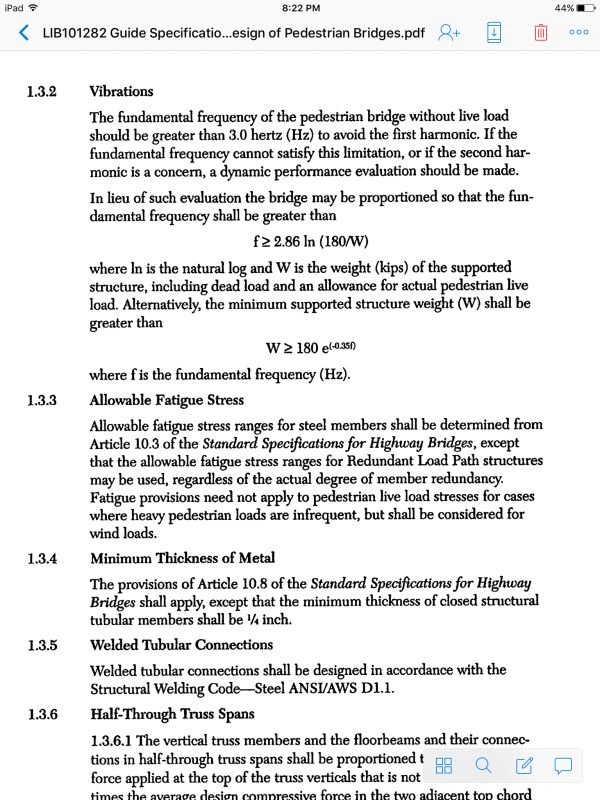

I don't have your answer but thought you might be interested in another source reference and some additional evaluation strategies. This is from AASHTO's guide specification for pedestrian bridges and would seem to be even more permissive than your other references.
RE: Vibration assessment of lightweight pedestrian bridge
Yeah I did find that in my search for answers, but you can't get away from the DG11 example that has greater than 6 Hz and finds acceleration unacceptable...
