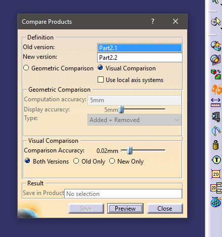

I wanted to write a catia macro for comparing 2 CATParts using SPA Analysis compare method.
Requirement
1: Macro should ask user to select 2 part.
2: Areas where both matches, should be in yellow color.
There are some sample code in documentation, but they are not working in CATIA V5R25. Will *.3DMap file work in R25? if not, what are the alternatives?

did you try compare product function?
if you're missing CATIA API, you can always use Win API to interact with the function.

I was trying to figure out if there is any CATIA API to do visual comparison to avoid WIN API. Also there are annotation captures in both the versions of part. I need to compare solid along with annotation, take a grab and put into ppt.
So even if I go with WIN API, I am not sure if each capture can be compared along with solid differences.
Currently I am following few steps
1. Add both parts in product
2. change 1st part color to green
3. change 2nd part color to red
4. display capture one by one
5. take a screen shot.
But if there is not difference in annotations, color is only red. So brings the question if any text is removed in new version , is it hidden and not known?
If I move one of the part by .1,.1,.1, then I cannot compare solid correctly?
Please suggest

Hello All,
I tried using WinAPI to compare the products. Facing below issue. Please help
1. Able to get the handle for window "Compare Products"
2. Able to get the handle for listbox "Selector003"
3. But could not able to assign product1 in listbox selection. Tried with Objselection.add Product1. But didn't work. Incase if I go with mouse click event. How do I find the cursor position of product1 in spec tree?
I need help to find out how to assign the product1 and product2 selection in Selector003 and Selector006 boxes.
Thanks in Advance

you select it then call center graph function?
did you try to add the instance name to the listbox then make it the selected item?

I tried to add instance name in listbox using LB_ADDSTRING and LB_SELECTSTRING functions,
- Instance name added to listbox and also selected
- Comboxbox appears in listbox and could see 2 items, Selected Instance name and "No Selection"
- But Preview button is not enabled.
Any suggestions would help,
