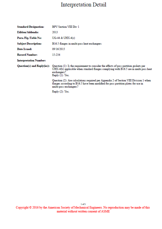

Dear Mike,
I have been working on this issue, and have come to a conclusion that if ASME B16.5 flanges are used a calculation as per Appendix-2 is required based on a code interpretation below,
Regards,
Stephen

RE: ASME B16.5 Flange with partiton plate for exchangers
YES, I agree that Appendix-2 calculation doesn't work for B16.5 flanges, but i think it is safer to go with APPEndix-2 rather than than getting in to an argument with AI.
If i will attend next audit for our shop, i will surely discuss this with team leader for our region.
Regards,
Stephen
