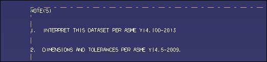

Hello All,
When I change graphic background to white color, white text of captures are invisible.
How can I change text to black with a VBA code or Catscript) in Catia 2015 while background is in white so that I can see the text?
Thank you All
Quin

Hi itsmyjob, below is what I got so far.
Here is an example of the capture's text I want to get to and change text color to black.

My above VBA code only gets to the point where I can access and display the captures on the monitor.
I think I need to obtain "text value" of the captures first, then change text color to black, but I do not know how.
Please help me out?

in order to script CATIA you need a minimum of understanding of CATIA.
the Capture is not a text, it is a definition of what is visible or not when showed. When you DisplayCapture, it actually change the visible state of elements.
So what you want to do is actually change the color of the FTA elements. So first you need to select them.
Play with the advance search function in CATIA, once you can select only what you need, then go back to scripting and do it.
I would be surprised if I could not find selection search or how to change color in v5automation file.
I will not give you code for free, I am looking for a job, while you are being paid. I will guide you to find what you are looking for.
Keep posting your progress, there was nothing about selecting text/FTA or changing color in what you posted... keep trying

OK...i got it FTA = Functional Tolerancing and Annotation.
How can I select the text element.
I searched the V5Automation but not able to locate "text" references yet.
Quin
RE: white background with black text
try first to select your text / FTA with the (advance) search tool (CTRL + F)
then go in CATIA VBA doc and search for "search"
Eric N.
