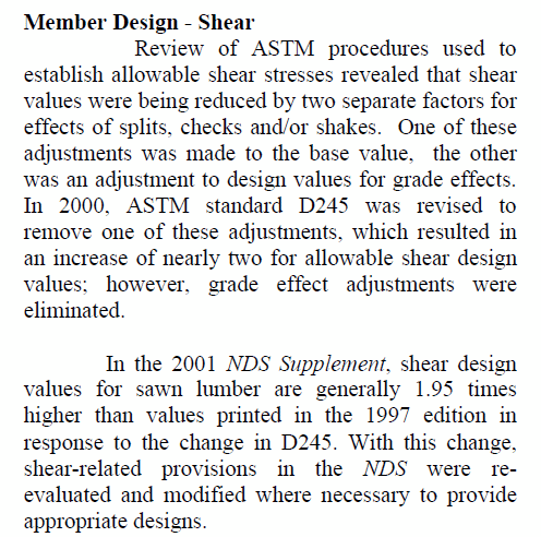

Weaverofduart - I believe this is what msquared48 has mentioned. The shear values published in "Timber Frame Joinery and Design Workbook" are outdated. A check of the internet indicates that book was published in 1996.
About the year 2000, an error in shear value calculations was discovered. This error has effected published shear values for decades. Here is the NDS explanation and source document for this excerpt.

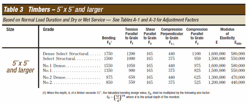

Allowable shear value for southern pine is now 165 psi (see below). If press operational loading is short (say <10 minutes), multiply 165 psi by the 1.6 load duration factor.
Here is this source document.
Perhaps the 300 psi shear value for Monterey Pine is from a newer publcation (post 2001).

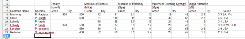

That is the data I have on the species. The Southern Pine aggregate species you mention plus radiata and redwood I'll be using for the press.
Taken from Bootle http://trove.nla.gov.au/work/8697176
Based on that data the Slash is superior to the long leaf. And the radiata superior to the Australian grown Loblolly but inferior to the American grown Loblolly.
