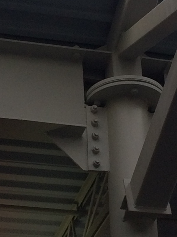

I thought of that too - just wasn't sure if you then begin developing a moment connection. Sort of like this one?
RE: Full-Depth Bolted Connection and a Stiffened Seat
JAE,
Yes, except that one is a moment connection, while the OP only wants a shear connection. The stiffener and bottom flange extension can be deleted, and more bolts can be added between the beam flanges.

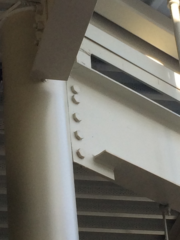

Some examples that I ran across this afternoon. Note:
1) I doubt the extensions were really necessary. Probably just EOR over specifying connection demands.
2) I too wonder about buckling checks that might apply to the extended web plates. I'm not familiar with an accepted method for evaluating such connections.
3) assuming that the web really is okay for shear, I favour using two columns of bolts as suggested previously.
