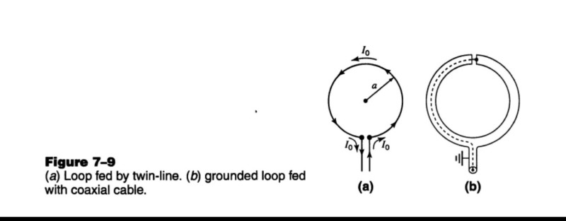

feed methods?

The first a) is just a loop fed with balanced transmission line. Nothing complicated.
The second b) seems to be just a (thicker) loop fed at the top with coax snuck through one arm.
The diagram for b) lacks detail. At first I thought it might be a shielded loop, but on closer inspection it's not. There's a good discussion of shielded loops here, for ref. But it's not that.
RE: feed methods?
Feed b) will radiate from the outer jacket of the cable. Hence it will affect your antenna pattern. Feed a) needs a balun to make it work normally.
