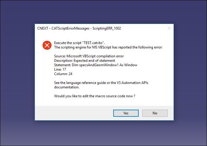

RE: SWITCH CATPART 3D ANNOTATION ON AND OFF
Hi Zecha,
Thank you for your post.
I am testing your code with CATIA 2015 with full licenses but
1) It does not work in both part document and product doc. See attached image for error.
2) Can it be run with VBA 7 in Catia 2016? If not, could you please show me how to?
Thank you in advance
Quin
Right off the bat, I notice you are using the wrong type of file, catvbs instead of CATSript.
Copy my code and paste it into Wordpad and save it as a .CATSript file type and see how that works out.

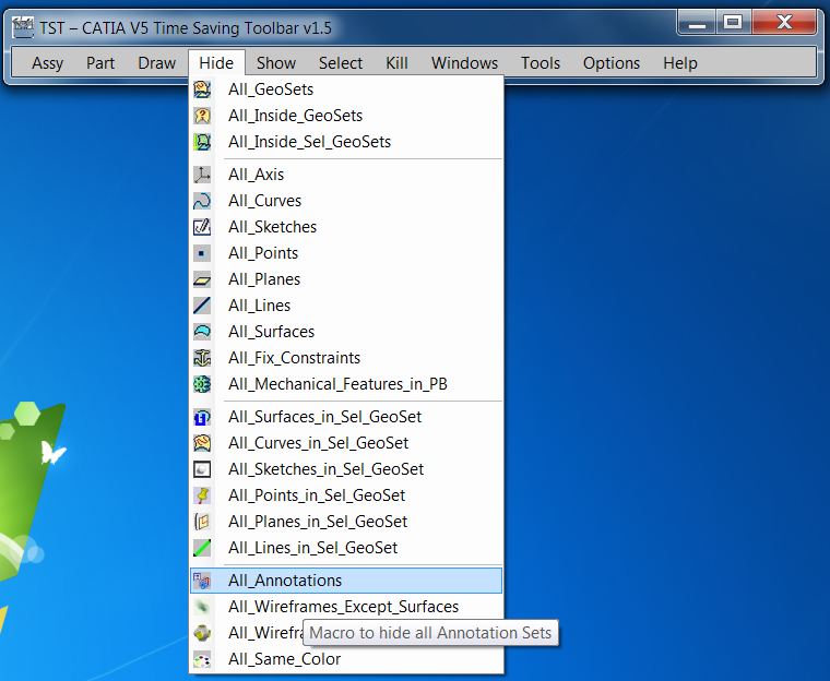

Hi Ferdo,
Thank you for sharing your tool bar.
I downloaded, run TST - CATIA V5 Time Saving Toolbar.exe but the annotation still does not show up.
1) What is FTA (workbend) in genenral? I have never known, seen and used it. Please elaborate
2) How could I make your tool bar worked?
3) Could you please share your code of switch annotation on/off with me? I want to incorporate it with my code.
I am using CATIA V5 2015 on Windows 10, 64 bit.
Your prompt reply is much appreciated.
Thank you
Quin
