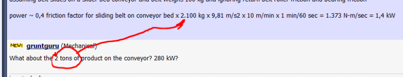

power = force x velocity
assuming belt slides on a slider bed conveyor and belt weighs 100 kg and ignoring return belt roller friction and bearing friction
power ~ 0,4 friction factor for sliding belt on conveyor bed x 2.100 kg x 9,81 m/s2 x 10 m/min x 1 min/60 sec = 1.373 N-m/sec = 1,4 kW
RE: Power kW needed on conveyor system
What about the 2 tons of product on the conveyor? 280 kW?

Not a decimal point? Oh well.blush
