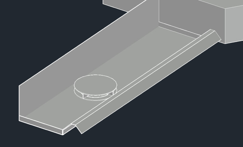

I am designing a floating skimmer that will draw off the top 1" of fluid in a pit. The skimmer has a sump that will hold ~4" of water (total volume of ~5 gallons). The suction line is connected to the bottom of the sump. The pump suction line is 2 inch schedule 40. My operating point on the pump curve with the pump I plan to use (using my estimated system curve) will be about 100 gpm. Using submergence rule, I should have ~6 feet of water to prevent air entrainment due to vortexing. I put a small vortex breaker at the suction line inlet, but have no experience with actual design of a vortex breaker, so I have concerns that I may still get air in the suction. I attached some images to show my current layout and design. CFD isn't an option to confirm the design. I've read some older threads on here and some articles online and think I have some basic direction I want to go. That said, anyone have any tips on avoiding air entrainment or vortex breaker design?
Edit: also want to add that the pit is open atmospheric and the fluid is water typically 70-95 degreeF.

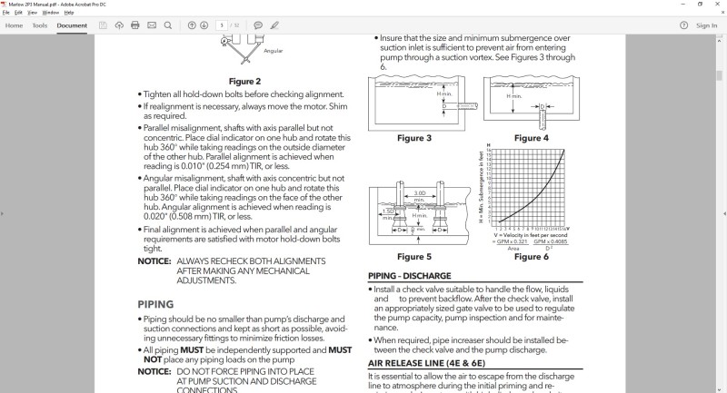

Not sure what a PD pump will get me? I plan to use a self priming centrifugal, but whatever pump type I use, to get the flow and head I need, I end up with high suction line velocity. I could go with much larger line size but there are cost and weight penalties to that. The velocity is what causes the potential for vortexing. I believe I can avoid the vortex with a breaker, but have never used one in any application.

Yes, I am sure of the data.
100 gpm => 0.222 ft^3/sec
Area = Pi*(2.067/2)^2 = 3.3556 in^2 = .023303 ft^2
V = Q/A = .222/.023303 = 9.536 ft/sec.
For general submergence recommended depth of suction inlet is ~ 6 foot (see chart). The same chart and equations (which give the same velocity as I calculated) are what seem to pop up over and over again when researching this topic.

Using the chart, velocity needs to be right around 1 ft/sec for 4.5" of water depth. I can obtain this by using a hat style vortex breaker (see below). If I size it to be 4D and locate it D/2 above the suction inlet, the annulus area will be 24.632 in2 (.171 ft2). 0.2222/0.171 => 1.3 ft/sec. I can adjust the dimensions of the hat to get the velocity down more. I believe this has the same effect as putting multiple connections and manifolding them together.

That's starting to look better, but my feeling remains that the 2" line at that point remains too small.
I don't know how to work it out exactly, but the acceleration of the liquid from 1.3 ft/sec to 10 ft/sec in a distance of 3 inches may require such a low pressure at the inlet that you'll either get a vacuum developing or create such a difference that the air will simply be sucked in direct even without a vortex.
From what I've found from a search on this site and elsewhere is a recommendation that the annular inlet speed into the hat is 0.5 ft/sec and no more than 1 ft/sec. Note that in general inlet lines to pumps are recommended to be around 3-5 ft/sec, not 10, therefore a lot of the guides need to be treated with caution for what you're trying to do. Why can't you make it a 3" pipe??
At 0.5 ft/sec, your diameter comes to 20" or 10D? , 1 ft/sec is 10" so maybe 16" is a bit more like it, especially if the top of the inlet to water level is actually only 3.5".
The issue as I see it given that there is not much about for this sort of thing is how much of a factor of safety do you want / need. If this thing starts gulping and entraining air, what is the impact.

I could go larger, but it adds weight and cost. Even at 3 inch, I am still prone to vortexing in this application. I may look at some additional configuration with in the sump to slow velocity and/or make the transition better. Possibly replace the first elbow suction elbow with a mini sump (maybe 4x4 or 4x6 cross section) to give additional space to accelerate the fluid.

I have been exploring a smaller sump within the large sump and/or using a 6x2 reducer as the bell inlet as well. But if a simple vortex breaker will get me there, that is what I would prefer.

This is the transition piece I am considering:

A lot better IMHO. Just needs am anti vortex plate over that pipe and you're there. Could you put a pipe on the other side as well??

Maybe this:
