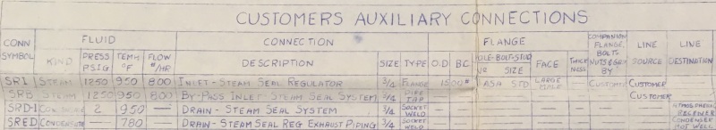

I've based the 950 deg F temp based off the seal steam header drain temp, which is assigned a temp of 950 deg F on our GE drawing.
I would not think the seal steam header would actually operate at that high temperature, but I am confused why the drain on that line would be assigned the 950 deg F temp if they did not expect or design the seal steam header for that temperature.

Do you have any TC's or temperature probes from operation that can substantiate your information? Have you discussed this with GE? Something is not right with your information.

We have not contacted GE yet. I would like to get a proper material analysis performed to determine the true pipe material. It is a mystery until we take either of those steps.
