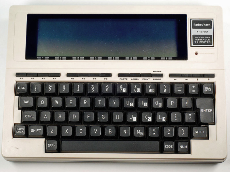

We tried it to read out rail car refrigerators using a Radio Shack Model 100 (dare I call it a laptop)?
Trying baseband we had absolutely abysmal results.
So we modulated, but the guy in charge did it at a lame frequency, half of what TV remotes used. He chose 27kHz IIRC.
Then we had to add reflectors so a lot of 6V lantern battery flashlights died for the cause.
All you needed was some direct sunlight to overwhelm the photo-diode.
Then we added a very narrow passband IR filter and that helped a lot.
Finally you could wear this plexiglass bib thingy that held the M100 at working height and the reader unit was a flashlight with a pistol grip, looking like some sort of exotic deathray.
We could read out 32k bytes in one try... um.. frequently.
