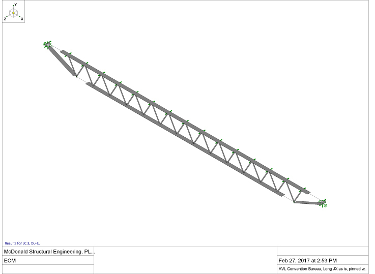

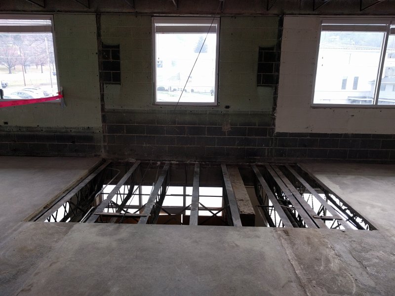

I am working on a 1952 office building (originally a school, but has been used as an office building for many years), in which there are existing open web steel joists to be shortened. The existing open web steel joists have a custom top and bottom chord in a WT-configuration. The top and bottom chords are made of the 1/8" (deep) !!! x 3 3/8" (wide) flange with a 3/8" (wide) x 3/4" (high) stem. The web is a continuous 5/8" diameter rod zigzagging and welded to the stem. These joists span over 24.5-ft, are spaced 2-ft o/c, and support a 2.5-in deep unreinforced concrete slab.
I did a RISA model, modeling the flanges as 7/32" x 3.375" plates (which has the same cross section area as the actual WT-members.) There are three rows of bridgeing, which I used for the unbraced length of top and bottom flanges, plus the web node spacing in the other direction. For allowable steel stresses I am using the then common A7 steel. For the top flange the RISA model comes up with "compressive stress fa exceeds F'e (Euler buckling)", and the bottom chord stressed at 465% of its allowable stress in its original condition. Even reducing the unbraced length of the top chord to 3" in the transverse direction (the existing slab undulates and locks in the joist from side way movement), the joist is not working.
Looking at joist performance, I did not observe signs of distress. There are areas of the slab cracked though, but without a general pattern.
I am hesitant to just modify the existing truss, even though the net-stresses are less (still over-stressed in RISA) even after shortening the joists by 7-ft. I am also hesitant removing the joists, as the existing slab is unreinforced and has a 65 year history of tension and compressive stresses within the slab based on the current joist layout. My inclination is to add new W8x18 joists side by side with the existing joists, plus adding the new joist web and bottom chord at the cut end.

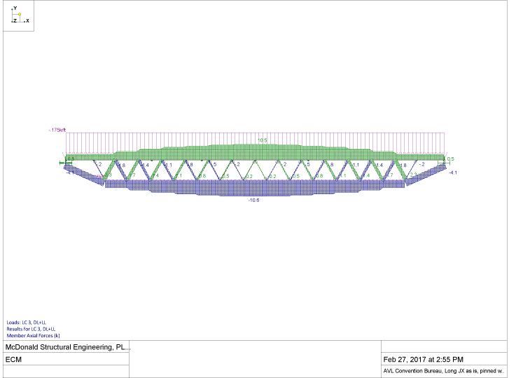

Can you post a picture of your RISA model with loadings? Post an isometric image of the plates and members rendered, post an image of the axial load diagrams, and a deflected shape diagram to make sure everything is working properly.
RE: Modeling and shortening open web steel joist
Thanks Everyone for the feedback and suggestions!
In the RISA forum of Eng-tips I got the question posted how to model a custom shape, but have not gotten a response yet. Now I am in process working my way through with it.
The topchord in the RISA model did not even work when braced at 3" o/c by being confined by the slab drooping on both sides of the flange. That is using the simplified plate shape.

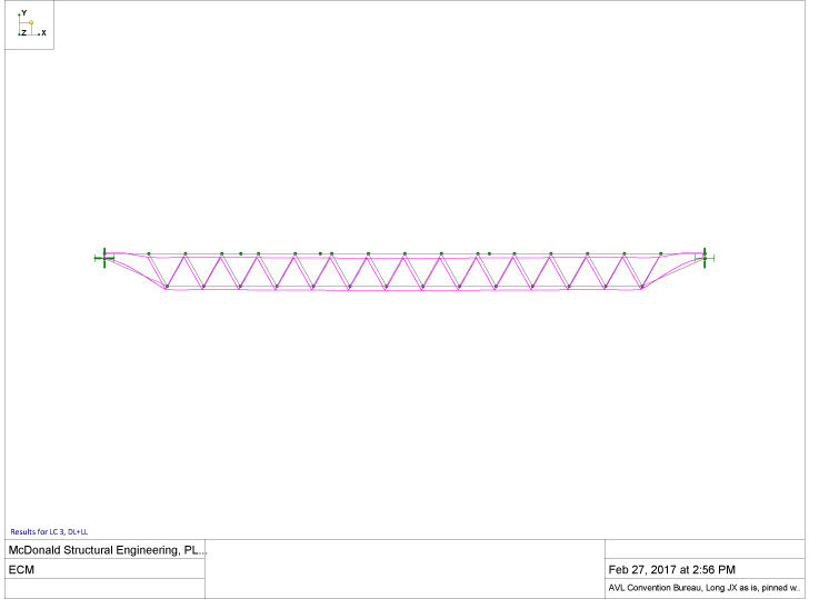

The bottom chord is in tension in the model. I did the webs both as pinned and fixed connection to the chords. The members at the joist seat I modeled as fixed, as there is no triangulation.
Fy with the A7 is 30 ksi.
I did a reaction check, but not a hand calc check on chord forces - thanks for making me do that wannabeSE. It turns out the RISA's tensile force and stress is correct, but also have a large moment at the ends, due to how it modeled it.
This is my first time posting, so not sure they'll come through:

In talking with joist fabricators' engineers over the years and doing what you're doing, most joists are designed as simply-supported, pin-roller. It looks like you have a pin-pin condition. Changing to pin-roller will affect how the joist behaves usually to better match the original intent. The pink deflected shape also looks odd at each end, as though there is some rotational fixity in the joint restraints.
Also, have you looked at any of the SJI specs from that time? They may give different allowable stresses than what RISA is using, which I assume is based on a current code.
Are the intermediate horizontal rollers in your model for the unbraced length?
It looks like you used a fixed-ended condition. A pretty grave error which makes a mess of your model results.
It looks like your top and bottom chords are taking some bending moment due to fixed supports which will increase the stress ratios. Like others suggested, I would idealize the support as a triangle and model it as a pin-roller. I would also model the top and bottom chords as custom WT shapes to gain more capacity and to be more accurate- more moment of inertia to increase Pcr, should increase your capacity significantly.
