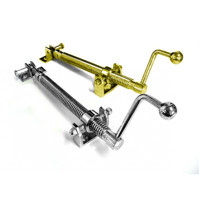

Since you only want to rotate 90* a shaft and gearbox is probably not the most efficient solution. Can you attach a lever to the table and move the end of that lever with a screw thread and handle?
