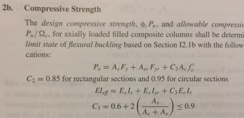

I am trying to ascertain whether filling HSS columns with concrete in a steel two-story building would have any significant impact in reducing lateral deflections of the structure. The idea is to use filled HSS tubes instead of a bracing system, since that would limit the architecture considerably. As it is, the structure is within parameters for seismic and wind loads; the problem is mainly the perception for occupants. Columns are 155x155mm HSS and all of them have ample capacity for the structure, the demand ratio is below 70% in all cases (even seismic). Problem is too much sway. I’ve read AISC specification and CIDECT guides regarding filled HSS, while I have a moderate understanding of the axial and flexural behavior of such system I have not found any specific information regarding the impact on deflection.
My intuition tells me that a HSS filled column should be very stiff compared to the empty HSS, however I wonder about cracking in the concrete and how this would affect its effectiveness. And whether using vertical rebar alone (no ties) would be enough to avoid excessive cracking of the concrete and perhaps gain more stiffness than using only concrete. My understanding is that the HSS capacity alone can be used to resist the shear, however the steel column can bend a good deal more than the concrete inside it so I have some doubts in this area (should I use shear capacity of the unreinforced concrete section instead?).

Probably helps with local buckling and fire, however.

Does filling with concrete really help with wall buckling for square/rectangular sections? I'd think that the walls of those shapes could just buckle outwards.
