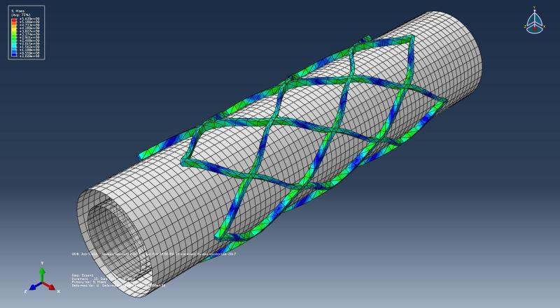

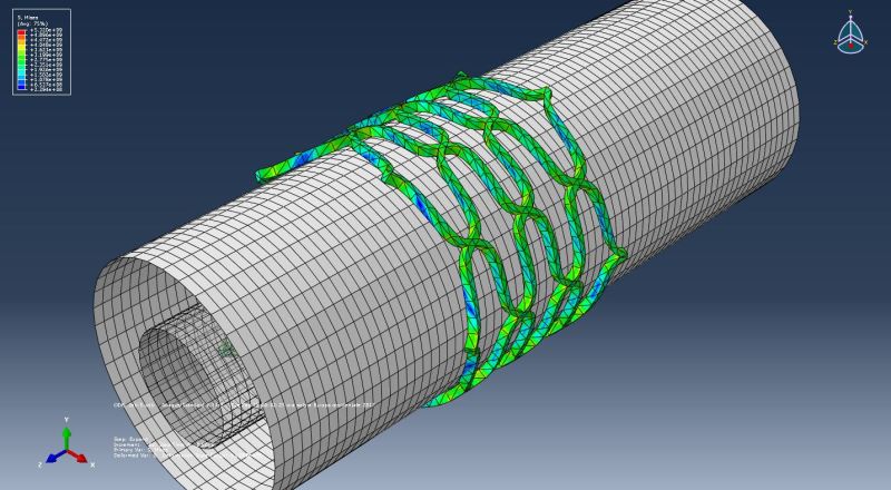

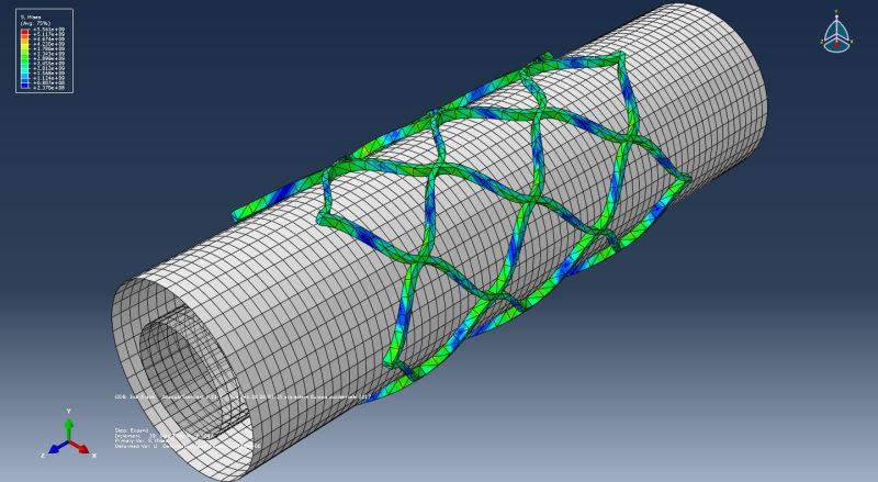

I have solved the above problems and I'm able to successfully carry out the simulation. I'm studying a lot of literature to try to understand the physical and mechanical problems that exist behind the simulations and I'm learning a lot. However in publications rarely explains the process used in Abaqus to get that solution.
I need some advice, if possible.
As you see my stent during expansion it reduces its size in the z direction, changing frighteningly its length. This must not happen. The stent expansion must take place without changing the length of the stent.
How can I approach to solving the problem?

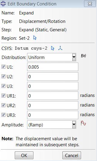

I've only Expand Step in which I've set a radial uniform Pressure Load and where BC's are:
Thank you
Luca
RE: Stent simulation with Abaqus: questions and doubts
Stents will often shorten during expansion - the cells have to open up as the device expands and this results in a reduction in total length. This is typically referred to as "foreshortening". If you want to minimize foreshortening you will need to redesign your stent and adjust the size/geometry of the cells. In your case it looks like you are over-expanding your stent. Take a look at current commercial devices and you might get some ideas how to reduce foreshortening.
Also, reconsider the mesh on your stent. It's not great.

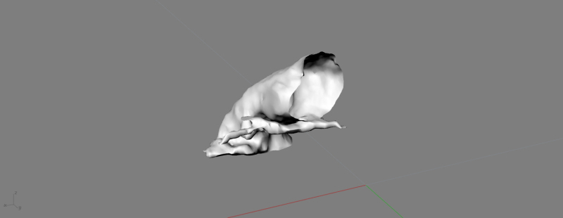

What you're proposing is really useful to me. I'm trying to draw my cell stent in 2D and then apply mesh in Abaqus and wrap it around the cylinder with the NMAP command. I have another problem though.
My stent addition to opening should also go to "bump" against the vein that, in my case, is represented by a .stl file that comes directly from the patient's radiological images. My surface is this:
How can I import it in Abaqus and make it interact with my stent? I tried .stl import but does not work.
Thank you again.
There are free converters available to convert your STL to a STEP. Otherwise, if you have access to an advanced CAD tool, you can do it straight from that tool (e.g., SolidWorks). Then, you can import the STEP file in the Part module.
You will have to specify an interaction property between the stent and the vessel. Vessel will also have to be specified with some mean pressure, I'd imagine.
Simulia Learning Community has an excellent best practices document that is worth looking into.
Are you new to this forum? If so, please read these FAQs:
http://www.eng-tips.com/faqs.cfm?fid=376
http://www.eng-tips.com/faqs.cfm?fid=1083
Hi IceBreakerSours, I use Rhinoceros that has a function to convert mesh to NURBS but what you get is a gross surface approximated by triangles and not a single compact surface. Practically this is a Reverse Engeneering process that would be very complex and long to do by hand. I haven't solidoworks. Have you experience about import of anatomical parts in ABAQUS in .stl format for simulation as what should I do? Do you think that if I import a .step file that comes from a .stl file will then be easier to manage this file in Abaqus (Part)?
