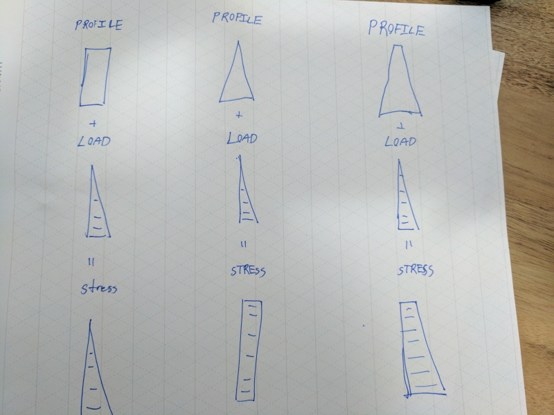

If a composite member has a uniform moment along it's length (dM=0), how do I calculate the required shear flow capacity between it's bonded components for composite behavior?
I understand this is a little academic for these boards, but separating the theory conversation from the application should keep the discussion on topic.

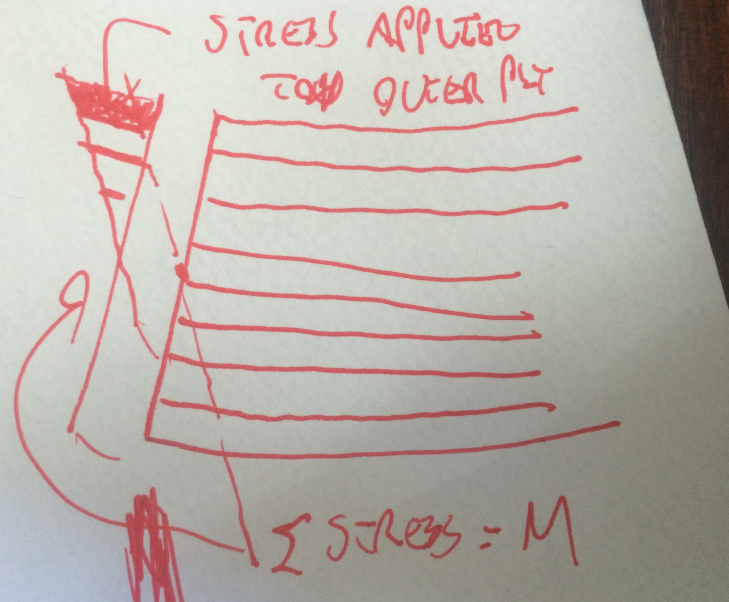

So say you stacked 10 1" plates together and bent them vs 1 10" tall plate. Would they behavior fundamentally different? Typical logic would be yes the 10" plate would have much larger moment of inertia than the individual plates. But maybe in this instance it doesn't matter. Not really sure. Maybe curvatures are restrained and locked to be the same so it doesn't matter?
The moments would have to be applied as a bunch of independent, linearly varying axial stresses that, when summed, would simulate the stress and strain profile of a composite member. Like I said, that's a tall order but, if it can be accomplished, there is no VQ/I demand between plies. Really, the end result would be a bunch of disconnected layers with linearly varying, mostly axial loads applied to them such that the aggregate condition would simulate the strain profile of a composite member.

In my case I have an eccentric axial load applied to a member, that's where the uniform load without shear is coming from. Although VQ/I = 0, the deflection of that member depends on I, the I is different for a composite member than for a bundle of fibers with no shear flow. So there must be a way to calculate the required cohesion for composite behavior from the moment.
Quote (KootK)
So with a symmetrical profile or a profile proportioned to the load shape the local dP/dA = Axial Stress. But with a non-symmetrical member that is not the same shape as the load profile, dP/dA =/= Axial Stress. So some sort of composite behavior is required.

I can't say I understand your sketch though... The 'load' you are applying is not that of a uniform moment?

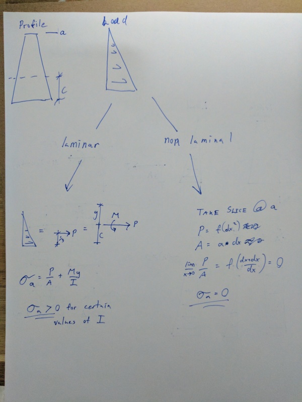

When I apply my eccentric tension to the member (triangle load distribution in the above sketch), convert the eccentric load to a Force and Moment at the centroid, and calculate the stress in the extreme fibers (P/A + My/I); I get a different stress result at any given location than I get when I slice the member and load into small slices and distribute a fraction of the load over the corresponding fraction of the member area.
In a member without laminar connections the method of slicing (dP/dA) should get the same result as any other method but if you calculate the bending stresses as a composite member (P/A + My/I) you get slightly different stresses. See the sketch, I'm afraid my notation is very rust, sorry.
Sorry about the unclear sketch earlier. The right most diagram is a simplification of my problem, the left and center sketches were my brainstorms on the rigid clamping approach, circumstances where I get the same stress result for shapes with or without laminar connection.
I'm not trying to be stubborn here, just this problem has me doubting.

OK... So it's not just a uniform moment at each end - you're also introducing additional axial forces.
My view would be this - based on nothing but intuition;
- Take the same member supported on perfect rotational pins, and supported vertically.
- Take the same rigid clamp and apply your moment, giving you a certain rotation and curvature of member
- Now apply your axial load (its concurrent but meh)
- I would guess that due to the curvature of the member, the axial load you are applying would either try 'straighten' the member (tension) or curve it further due to eccentric load (compression).
- This 'straightening' or 'additional curving' would result in some tangible vertical shear force at the support.
- This shear force is what you would use to calculate the required shear flow

I don't believe that the presence of the axial stress changes anything. By negative superposition, you can strip it out and again deal with the uniform moment as before.

In the case of the latest sketch by wadavis, in order to act compositely, every horizontal section through the profile has a shear flow wherever the area under the load diagram above or below the section differs from the area under the stress diagram above or below the section. The shear flow is equal to that difference.
