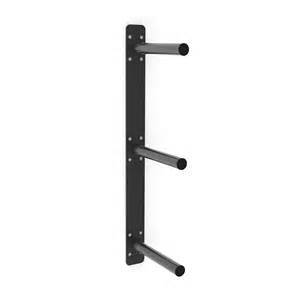

I'm on the road at the moment so won't be able to provide a sketch. However, what I've got is an EXISTING 390mm x 190mm Unit Concrete block wall. The owner wants to essentially bolt a rack of powerlifting weights (see picture below). I want to design the wall assuming that it is unreinforced ( apologies I should have mentioned this in my first post). I guess my main concern is pulling out a block due to the tension force. How do I check this? I've checked the moment capacity of the wall, shear etc.

If it is indeed unreinforced, I would recommend that you provide a vertical steel or timber member behind the bracket, extending and connected floor to floor, and connect the bracket to that.

That rack does not appear capable of supporting 3 tons
RE: Blockwork Wall with 3 Tonne object hanging from side of wall
Run a channel up either side with a member across the bottom of the unit and support the channels at the top and bottom. Assuming an e of 1', you have a 3.3 'K moment (tonnes and 2 channels) and with connection at top and bottom, assumed 9' apart, you have a horizontal loading of about 300 or 400 lbs applied at the top of the wall and the base. Should be doable...
The bracket shown, as noted, does not appear to be anywhere adequate.
Dik
It is probably only adequate if it has 4 bolts at each pipe to reduce the bending length of the plate. Have to take that localized couple account for the bolt loads as well if you don't add supplementary steel as dlk posted.
I'm not sure how he is getting 3 tons, however. That rack looks only capable of holding 6 or so 45 lb. plates on each pipe.

My version of the detailing that everyone seems to be migrating towards. I like to create a gap between the support member and the wall to prevent prying action. Probably paranoia but the gap kind winds up in there naturally anyhow. I also wouldn't mind seeing a cross member or two between adjacent racks to deal with incidental out of plane loads. In a gym setting, you'll have plenty of that.
