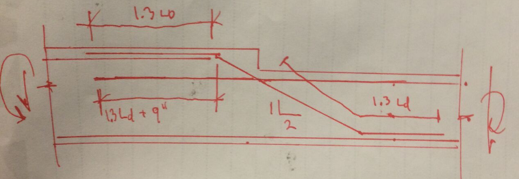

Hello, Im wondering how do you guys solve the problem when a concrete slab has a sudden change of thickness (above a wall).
I have a cantilever slab (balcony) on the left side - 18 cm thick and the rest of the plate is 12 cm.
I have to model this plate as one element (because of cantilever part that has to be 'fixed') but im wondering what is the best solution for reinforcement detail. I dont like the first sketch very much because i think there is too much unreinforced concrete above (upper reinforcement mesh) i think it may crack?!
Im also not a fan of 2nd sketch since the reinforcement is not in one line (upper reinforcement in the cantilever part is disconnected from the rest of the slab - there is a disconnect of reinforcement at the area with the biggest bending moment.
Id really appreicate some suggestions or sketches.
TNX
RE: reinforcement of concrete slab
There is not much wrong with the first approach, if the 120 slab is deep enough to resist the negative moment from the cantilever. 120 is quite thin. You could add some top reinforcement in the cantilever if you want, but keep plenty of cover.
The second approach is dead wrong, as you do not have continuity of the reinforcement. But you know that.

I typically terminate the top rebar with a hook on the thicker slab and develop the top reinforcement from the balcony into the thicker slab.
I agree with bhiggins detail.
bhiggins,
That is NOT a good detail. While it will have sufficient strength, it would be much better to fully develop the hook. There is nothing stopping a shallow angle crack at the step from basically causing delamination .
The sketch below shows what I might do. Very similar to BHiggins' latest. In terms of strict strut and tie methodology, there are a couple of holes. I consider it acceptable for a lightly reinforced slab with distributed flexure though. And it's easy to build.
Structurally, for a ~2.5" step, I think that OP's original option one would be fine. My only concern there is durability. With ~3.5" cover on the top bars, I might be concerned with top side crack widths should the balcony slab ever actually crack. I'm curious to know what others think of that supposition.

I'm lost, as are others, on why this occurs in the first place, but I also fail to understand why you would attempt to use any of the concrete above the interior top surface since the weak point is still the transition. Design a 120mm (or whatever it takes) slab right through and assume it's carrying an extra 60mm of concrete topping outside.
Quote (OldBldgGuy)
I assume it is an external/internal junction, and internally there is a lower slab level to allow finishes to be installed. Also assuming it's carrying a 60mm unreinforced topping is not a good idea in my opinion. It might be OK for strength, but a balcony slab should have reinforcement near the top face to control cracking.
I agree with KootKs detail. Or, for larger steps, a Z bar so the vertical face of the step can fully develop.
I usually use the third one, but use a hooked bar to develop it. KootK's detail works, but, is slightly more costly.
Dik
bhiggins,
The sloping bar - yes, as per Koot's detail, with a bit more slope than yours.
The open U,s no, development is still inadequate, and would be painful to install.
