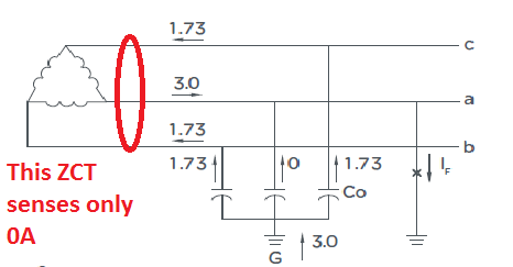

How do you set the current setting coming from the ZCT? Does ZCT produce any secondary current at all?
If it is a single feeder in a power system (against the radial) the ZCT balances the charging current 3Ic in case of single phase to ground fault and produces zero flux. On the other hand, in case of radial feeders there would be some small current from the ZCT? Has my understanding right?

Great illustration, which shows an obvious answer. Move the CT so it lies between the cable capacitance and the fault. Since this may be a bit impractical, a voltage based scheme may be in order.
RE: ZCT setting in ungrounded systems
For ungrounded systems with only 1 feeder is true that the ZCT (window transformer) do not see earth fault current because the current of the faulted phase is the sum of the other phases (opossite direction) and always the ZCT see zero amper. (IEEE papaer "Considerations for ground fault protection in medium-voltage industrial and cogeneration systems D.J. Love and N. Hashemi)
For the small network can use the 3V0 element for detection (PTs connected in grounded wye indicated by Waross).
The phase to earth capacitive charging produces more high values of residual voltage (3V0) (opposite to big network that for the same fault type have low values of 3V0)
