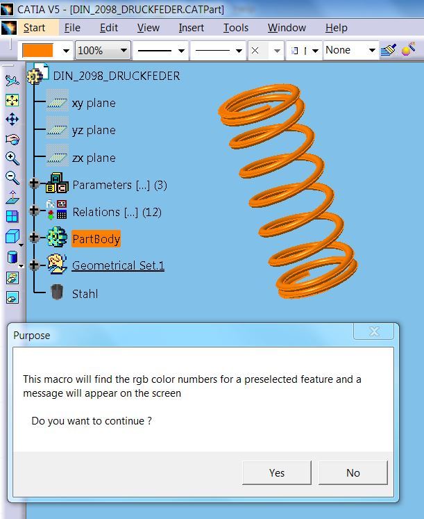

I run your VBA program in CATIA V5-R2015 and V5-2016 but
1) I did not ask the user for picking a feature or part to get color from
2) As per attached image, part's color would not seem, r = 0, g = 0, b = 0
My objective is that as soon as you run the program, it will automatically access the part body of active document/Catia part, display part's current color, save it to a variable, change current color to white, and change white color back to its previous color.
Even you are expert in Catia VBA programming, but I do believe you are able to help me out on above macro events.
Thank you in advance
Quin
RE: VBA MACROS - GET PART BODY COLOR AND CHANGE IT TO WHITE COLOR, THEN GO BACK TO PREVIOUS COLOR
If you want to let user to pick something after launching the macro, you need something else but once again, if you want to learn, search first a solution thinking before what you want to achieve with the macro, and think to steps of your macro, for example:
1) first preselect the feature/body or let user select after hit run macro ?
2) get the color and store it
3) set new color
4) change the background, zoom the part, iso position, compass off, tree structure off?
4) take the screenshot?
a.s.o. ........
There are several macros on web regarding this, also you can find in CATIA_Portable_Script_Center.
