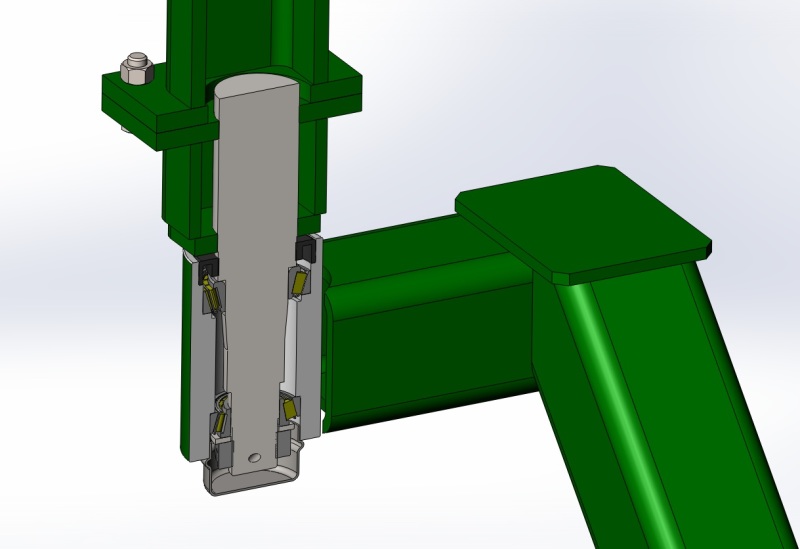

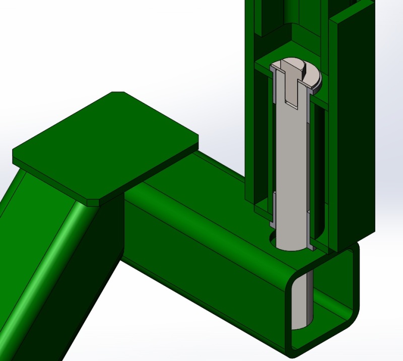

Hello forum, I posted this in the Agricultural forum but it seems nothing ever gets posted there. I am working to improve our 3 point spider cultivator and want to weld up a pair of casters to mount on it. The implement weighs approximately 3000 lbs. and mounts to the 3 point hitch of our tractor. I have the arm design worked out but wanted some input on the pivot section. Looking at zero turn mower pivot tubes as an example, they typically use bushings and/or bearing combinations. Do you think that this product would work with a 1 1/4" shaft pressed fit into schedule 80 tube? https://www.mcmaster.com/#2938t63/=16hi5ll. These bushings have quite a large dynamic load capacity.

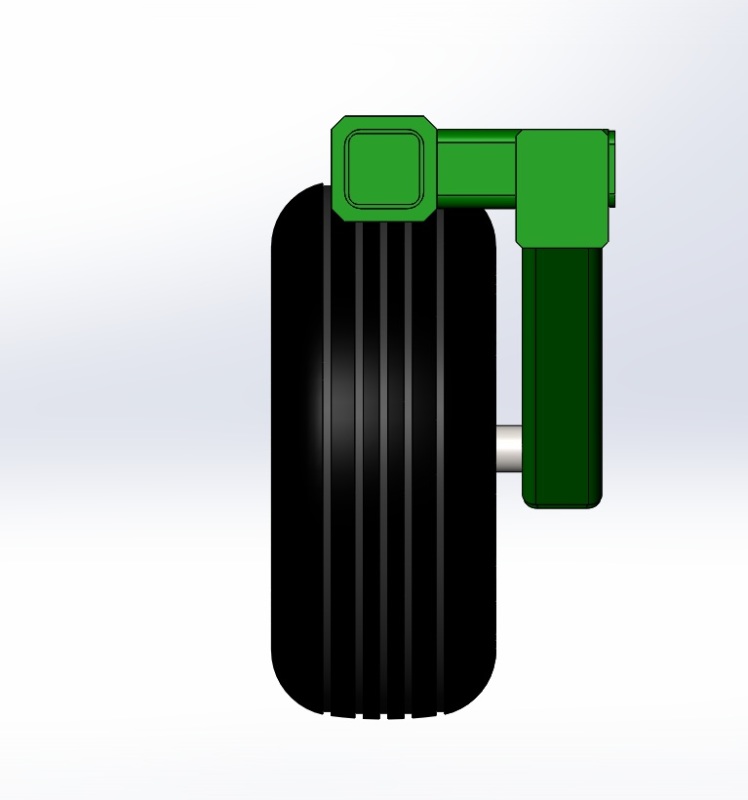

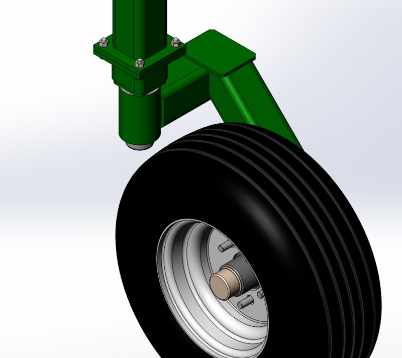

I have attached a few pics of the design from Solidworks. The square tubing is 3 x 3 x 1/4 wall A36 and the shaft is 1 1/4" CR 1020 steel. The pivot tube is X Strong Sch 80 1 1/2" x 1 3/4" long pipe to press the bushings and shaft into. The shaft has a 1/2-20 tapped end for the bolt to apply the necessary preload. The shaft is welded to the square tube via a through hole. The hub and spindle are rated for 1750lbs, two casters total 3500 lbs capacity. Not being familiar with typical tapered roller bearing applications do manufacturers machine out the pivot tube for the bearings or use stock material and press fit?
I could also use these as well but there is significant price difference versus the bushings. Also from a maintenance point the bushings seem a better fit.
https://www.mcmaster.com/#5709k86/=16hjkkm
Overview image of caster design
Cross section of end bolt, shaft, pivot tube, and bushings; one on top and one on bottom.
FEM of caster shaft showing displacement. von Mises stress is well within FOS.
Thank you for any suggestions or information.

Eyeballing it, your swivel looks WAY too delicate.
Note that the wheel load X distance from the swivel axis to the tire contact patch puts a huge moment on the swivel. Two bushings adjacent to one another will each see a force greatly magnified from the load on the wheel.
Take a look at a typical 3000# caster; the swivel comprises a pair of tapered roller bearings spaced some distance apart. The lower one is typically much larger than the upper one. Both are typically much larger than the one you have identified from Macarco.
Another possibility for the swivel is the stub axle sold for travel trailers, which typically has two ball or tapered roller bearings of about the size you have identified, spaced pretty far apart, another way to deal with a large moment.
You can't press any bearing directly into any as-supplied pipe or tube of any size; one or both parts will fail soon. You need to bore and ream the pipe, probably to a tolerance of a couple of ten-thousandths of in inch. The fat end of the bearing's cup also needs a thrust surface on which to bear, pretty damn square to the bore. You need to study the thick 'engineering' portion of a Timken catalog or equivalent.

If the pivot point is not rotating frequently, i prefer to use bushing, otherwise it is better to use bearing.
How does the bottom portion (square tube) of the pivot pin is secured?

BEMPE16524, Thanks for the reply. The caster does not really spin much, not like a rotating shaft that spins at 250 rpm. This is just a large version of a zero turn front caster with a one sided fork. The pivot shaft is welded to the square tube on the bottom face as well as the inside top and bottom face where accessible.
Shaft welded to square tube horizontal arm.

I think you should add some sort of greasing point on the bushing side.
Besides helping the movement, it will help you a lot during maintenance when you need to disassemble the parts.

Beside the caster mounting shaft being questionable in size, I believe that you may not have adequate bearing surface contacting the caster mounting shaft which in due time you will see compacted holes and cracked welds. You would not need to increase the wall thickness in that portion of the square tubing. The welding around the shaft on top of the square tubing will also interfere with the assembly,shown as a cross section, above that tubing. You may also double check on the wall thickness of the square tube where the square shaft is attached. Agricultural land surfaces can be rough on equipment, so I would expect 3000lbs load from wheels can be significantly magnified.
RE: Spider Gang Cultivator Caster Design
The two pictures you have attached of other designs should be highly informative for you- notice that in both of them the pin/bushing set is much taller that your arrangement is. This is to counteract the large moment that MikeHalloran is talking about.
Also notice that in both cases, the centerline of the pin/bushing assembly is closer to the centerline of the wheel than in your arrangement- this also reduces the moment applied to the pin/bushing assembly.
Also notice that in both cases, the load path from the wheel, through the pin/bushing pair, into the structure passes through relatively thick sections with long, simple welds (or cast parts in the case of the Deere arrangment) which keeps the loads in the welds low.
That first arrangement is very simple and to my eye looks like a very robust and easy to disassemble/maintain way to solve this problem. If I were in your shoes I would copy it closely, sized for the load you need.
Not sure what type of loads you are applying in your FEA- but make sure to account for impact loading, not just static and operating loads. Your assembly is not sprung, which means when your caster hits a rock or stump or whatever, the load into the bushing, pin, and structural attachments thereof has the possibility of spiking to a very high number.

See this top view.
As far as the FEA analysis, that was done with a 7000lbs static load with the radial load distributed on the whole shaft with the end fixed. I am currently learning how to do impact loading using Solidworks which is, as far as the Solidworks FEA is concerned, done using nonlinear dynamic analysis.

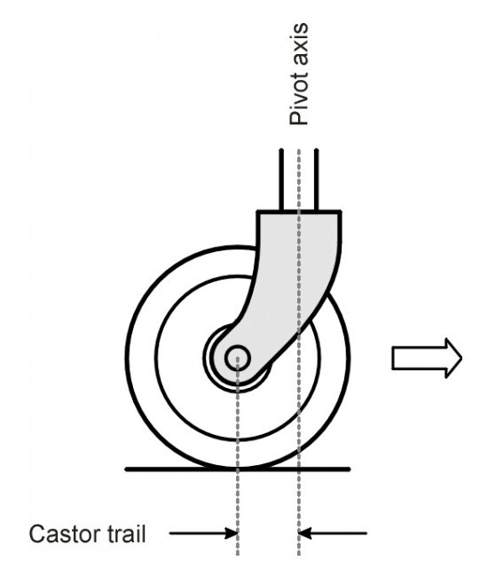

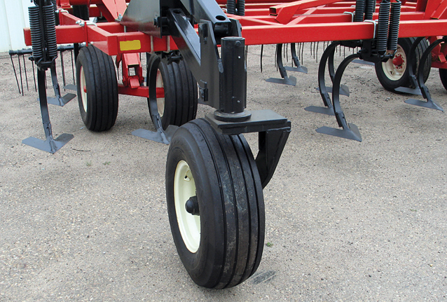

jgKRI was likely referring to the "trail" of the caster, the distance between the caster pivot axis and the wheel rotational axis. Your overhead view shows this non zero distance. Of course, it should be non zero. I believe jgKRI's point is that it should be minimized within certain bounds.
Mr. Nescius,
Thanks for clarifying that for me. I am not that familiar with caster vernacular. I found this image and read about the caster trail and now I understand it. I kept the angle at 45 degrees like the JD to help with the height of the assembly and to be able to use a tire of sufficient load capacity. The tire height and the implement height was the constraining aspects of the project. I am also trying use steel sections and scrap we have around the farm.
Here is a picture of a Lilliston spider cultivator. Ours is not this big and is another brand.

Quote (Nescius)
Yes, I was referring to trail.
Lonjevity Farms:
In the picture you posted, 'castor trail' is what I was talking about as Nescius explained.
Your first explanation, that the center line of the wheel is in line with the pivot axis, is also important but I assumed you understood this (as you clearly do).
The trail dimension does two things- both relatively simple and intuitive. One: the longer the trail is, the higher the apparent force keeping the tire parallel to the direction of travel of the pivot. This is a good thing. Two: the longer the trail is, the higher the moment put into the pivot system by the wheel loading. This is not good or bad, it just needs to be accounted for.
With that said, my engineering brain likes both details you have come up with. My suspicion is that the arrangement with roller bearings is substantially more expensive, but it looks like it will be very robust in all directions.
The only thing I would check on that design- when moment is applied to the stub shaft, it has to transfer that moment back into the structure (as we've talked about a few different ways). The weld at the bottom will almost certainly not be strong enough to handle this on its own. There needs to be some reinforcement at the opposite end of the stub shaft (similar to your gusset/weld arrangement on the top end of the design using bushings). The further you can get that connection from the bearings, the more robust the assembly will be.
I'm assuming you know this already and have some detail to anchor the top end of the stub shaft, but thought I'd bring it up just to make sure.

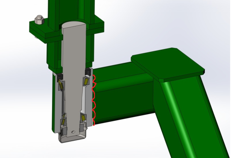

I see a problem with the machined surfaces for the roller bearings and seal being exposed to the heat and deformation of the welding of the hub to the square tube.
That's legitimate, but personally I wouldn't be THAT worried about it. This isn't a high speed rotating assembly. As long as the bearings fit after welding, the assembly will function as intended.

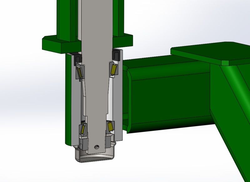

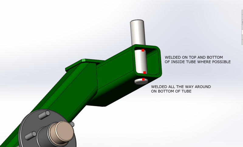

I have modified the caster so the spindle is to be welded and supported on both ends as you and mfgenggear suggested. The mid section is bolted to the support leg. This will allow replacement of the spindle section when it wears without having to manufacture another support leg. The mid section is just a piece of tube welded to the top and bottom plate with holes to accommodate the spindle for welding.
Lnewqban,
As far as the heat on the spindle from welding, don't trailer companies weld the spindles into round and square tube for the axles with no problems with bearing fitment?
Section view of middle section bolted to support leg
Iso view of caster.

Quote (Lonjevity Farms)
Yes- the spindle can be welded all sorts of ways without much problem, because any welding you'd be likely to do to create an axle would involve a weld that is symmetrical around the long axis of the spindle, meaning it probably won't distort much.
What he's talking about (I think..) is not the spindle attachment, but the hub. Shown below in red.
That weld is going to tend to distort the bearing mounting surfaces, pulling the bores out of round.
As I said, in my opinion this is not of major concern because this assembly isn't going to rotate around that spindle at high speed. In something like a trailer or other system where the spindle is spinning at a few hundred or thousand RPM, bearing alignment is really important and it's crucial that the bearing surfaces are all accurately machined and aligned well.
This application loads the bearings in a static condition. This means that bearing seating bore distortion is only a problem if it is REALLY bad.
You can protect against this problem by selecting bearings which will tolerate a little bit of misalignment, just in case the hub body distorts when it is welded.
The other way to do it would be to machine the bearing surfaces in the bore after the assembly is already welded together- but this changes the operation from one which can be done easily on a lathe, to one which likely requires very precise work on a mill- meaning it's a cost adder. For this application I do not believe you need that level of precision.
Lnewqban,
As jgKRI has well explained above, I was referring to the hub.
Predicting the deformation of the surfaces to take the bearings is as difficult as to achieve all hub-frame joints to be welded exactly alike.
I am not criticizing your idea of the bearings, just transferring my practical experience with similar assemblies:
1) The outer ring of the bearing should not rotate or slide within the hub. For the interference fit between bearing and hub, the allowance per inch of diameter usually ranges from 0.001 inch to 0.0025 inch. Anything bigger than that makes installation very difficult. Heat, steel and tight dimensions don't mix well.
2) For high loads and little rotation, flat bearings work longer because they have a big surface. Ball bearings transfer loads through several points and roller bearings through lines. Because dynamic lubrication is marginal and pressures huge, the tracks tend to develop pitting or/and valleys after some time.
3) Those pressures can spike and quickly destroy the bearings when the two cavities for the bearings are not perfectly aligned and concentric. Machining must be precise regarding that; making a mandrel is recommended.

Thanks jgKRI. Does the caster pivot spindle look satisfactory with the changes I made?

Quote (lqnewban)
I know you are not criticizing and I hope you keep the recommendations coming. Are the flat bearings you are referring to the ones they use in casters?
Sorry, I call flat the plain type bearing, consisting of just a bearing surface and no rolling elements.
It could be cylindrical a thrust bearing combination.
"God will not look you over for medals, degrees or diplomas, but for scars." - Elbert Hubbard
Yes, I think the designs you have come up with look pretty reasonable.
Just make sure:
1) You're accounting for dynamic loading
2) You're sizing bearings based on their STATIC load ratngs. This is not a dynamic application (no constant rotation).
Just make sure your forces all check out and I think you're ok.
