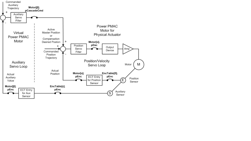

This specific example is a clamp, where the user inputs how much force they'd like the clamp to exert.
1) The ideal clamp is such that you tell it to provide 1 pound of force, and it provides 1 pound of force. In reality for this application, the clamp's force capability is dependent on the actual present pressure the clamp is providing, due to unusual properties of the material. So I ask it to provide 1 pound of force, and it thinks it's giving 1 pound of force, but a separate pressure sensor says it's offset by some amount. The magnitude and direction of the offset depends on how much it's actually presently pressing.
2) There is a pressure sensor to measure the force, as an independent measurement of what the clamp thinks it's doing. My controller's purpose is to adjust the requested force (the setpoint) to this clamp, such that the actual outputted force remains constant (1 pound).
3) My hope is to understand where to look for further study of this, or how to do an analysis that exposes what situations this can be controlled in a stable manner (how bandwidth changes, phase is shifted, etc).
As an example of first-pass thinking, it's clear that this will be hard to control in a runaway scenario, where the force radically increases with the slightest commanded force, and in the same direction: I ask for 0.1 pounds of force, and the actuator provides 10 pounds of force at the sensor since it's force exertion offset depends on the actual present force. But as soon as it provides 10 pounds of force, I realize this and decrease the commanded SP to a smaller value but not enough, so the force capabilities change and so it actually outputs 50 pounds of force. It's quite sensitive to the correction. And so on until it goes unstable either runaway, or oscillating neutrally stable, or oscillating unstable.
On the flip side, it's clear that this is much easier to control if the force is ever so slightly convergent, opposite the direction of the actual present force. I ask for 0.1 pounds, it gives 0.099 pounds at the sensor. So I increase the SP and ask for 1 pound, and it gives 0.95 pounds. Then I ask for 1.1 pounds, and it overshoots and gives 1.05 pounds, and I decrease to 1.08 pounds and it's right around 1 pound. Small deviations are easy to control and this just jitters around the desired 1 pound SP indefinitely.

We do this all the time for press control where one controls the position most of the time but the force is controlled once contact is made.
OK, I understand this is just an example. How is this force being applied. Normally we/our customers use hydraulics. There are 2 ways to calculate a force. One is a load cell. This is the most accurate because the load cell is between the end of the cylinder rod and the work piece. The other is to use 2 pressure sensors, one for each end of the cylinder. The force is calculated by multiplying the pressure by the area of each side and subtracting. However, this doesn't account for seal friction or the offset you mention. Still we can control the force within the seal friction. The problem you mention can also be due to load induced pressures. We have software offset to zero out the force when not in contact. All this is normal.
Now if you are really working in the 1 lbf range then friction is you enemy and you need to use load cells.

Controlling force is not a low bandwidth application. Force controls acceleration, acceleration leads velocity and velocity leads position. The update rate should be 1KHz or faster.
There is a differential equation for the rate of change of pressure with respect to flow.
dP/dt=B*Q(t)/V
P is pressure
B is the bulk modulus of the fluid
Q(t) is the flow as a function of time
V is the volume of fluid under pressure.

I have been traveling for the last several days, and I think Peter has given you a good start.
If I understand correctly what you are trying to do, we have successfully used an approach we call "cascaded servo loops" for many years now. (I am certainly not saying this is the only way.) We have used it with both electromechanical and electrohydraulic actuators, and systems ranging from giant press brakes on the large side to semiconductor wire bonding on the small side.
In this approach, the "inner loop" is a standard positioning loop, often a PID loop with standard reference trajectory inputs. It is used by itself when you are moving in free air. When the system comes in contact with the material it has to apply a force to, an outer force loop is engaged. There is a commanded force set point, a measured force feedback value, and a feedback filter (usually PI is enough).
The output of this feedback loop acts as a position offset command to the inner loop, adding to the trajectory-commanded value (which is usually not changing in this mode). If the measured force is less than commanded, the position command is offset further into the material; if it is greater than commanded, it is offset in the direction out of the material.
In our customers' experience over the last 25 years using this technique, it has not been difficult to get stability with these loops. They generally spend more time figuring out how to properly manage the transitions of engaging and disengaging the outer loop.
Here is a diagram we use in our manuals to explain the technique. The labels specific to our controller are not important to you. Focus on the loop topology.
