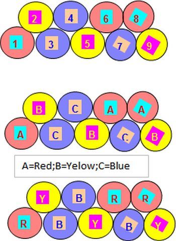

If the cables are touching and the configuration is r-y-b b-y-r b-r-y then unbalance could be 11.8% See:
A CABLE CONFIGURATION TECHNIQUE FOR THE BALANCE OF CURRENT DISTRIBUTION IN PARALLEL CABLES
http://jmst.ntou.edu.tw/marine/18-2/290-297.pdf
IS_1 configuration.
Table 2. Results for a 3φ3W 9-cable system with structure
RE: Current sharing in parallel circuits
thanks for response, especially paper provided by 7anoter4. As usual theory never matches practice and our install differs slightly from the cases presented in that particular paper.
various cases of the cable installation along the route are shown in the attached. part of problem is that the cable rack in the route differs in width so the 2d spacing that was meant to be achieved was not possible due to cable rack

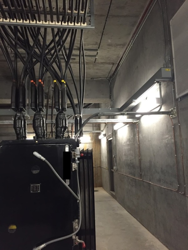

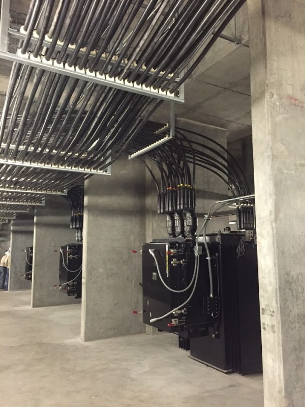

I have ETAP. It most definitely is not capable of modeling and determining current sharing by individual cables in a cable racking system like this:

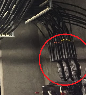

Have you got a close-up or a drawing of whatever that transition arrangement is where the cables joint the transformer? it's very different to anything we use over here.

Are you talking about this part?

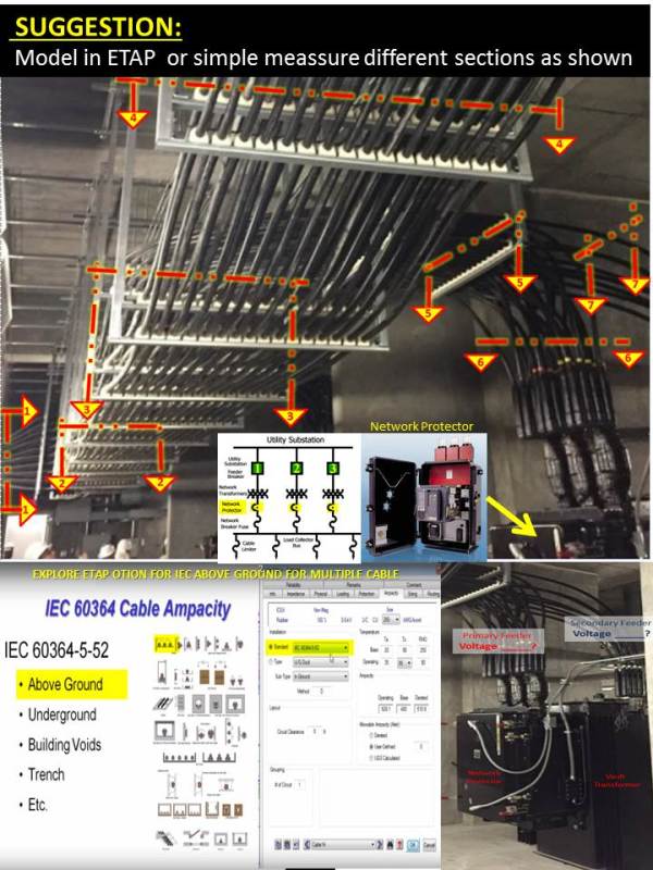

To support further calculation and understand the cause of current imbalance, we suggest to measure with a clamp amp meter the current on each cable at the beginning and the end of the tray to determine the location and cause of the current imbalance.
If there is significant current induction by other feeder, particularly in the transition areas, check if there is a possibility to shield this region to minimize the imbalance effect.

Yeah, that's the one - it has attracted my curiosity because it is quite different to what I'm familiar with on LV gear. We normally have a cable termination box where the armour (if any) ends at a gland and the conductors terminate to a palm connector within the box. The palm is sometimes a bushing through the wall of the main tank, other times it may be part of a disconnection link. We do use vertical bushings on the tank top for connection to bare bars, but that's typically at higher voltages.
In the very bottom of the picture is a Richards 313 network protector. It is a throated connection to the transformer to the right. This is a 5 x 2MVA 480V spot network system. On top of the network protector are Bussmann 5000 amp KPRC fuses. On top of the fuses are HOMAC flood seal connectors (175 series I believe). The cables are just ordinary xhhw-2 600V aluminum 750MCM - no shield or armor.
Thanks. Now I've found those items on the web I can see how it goes together. I hadn't realised what the network protector was, and the spreader plates above aren't something we see in that form. The whole thing wrapped in tape doesn't give much away. My little bit of learning for today. smile Time for a beer!

Beside the picture, this is what we know about your system, questions and suggestion:
• The installation consists of 9 -3 x r-y-b trefoil groups ?
• The current sharing between phases is imbalanced greater than 10%.
• This is a 5 x 2MVA, 480V spot network with a Richards 313 network protector & 5000 amp KPRC fuses. (primary side ? )
• What is the voltage and ampacity on the secondary side?. There is any single phase connected load that is causing current imbalance?
• Appears that there are primary and secondary feeders running in parallel. Please confirm
• Consult with ETAP to model the above ground cablesystem per IEC 60364 by section as was suggested. Measuring ampacity is another option in lieu of calculation.

Thank you for the suggestion. I am not the OP; I am not aware of any issues at the site I posted pictures of. I don't have the IEC 60364 module nor have I ever worked with IEC standards but I'll look into that.

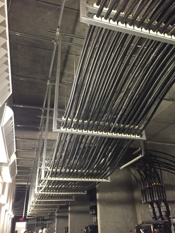

No particular expertise claimed here, but I see something that reminds me of a story.
<story>
Some of my friends were assembling a three phase generator, and didn't have a single large or trefoil bushing to get the connecting cables through the steel wall of the termination box, so they used three individual bushings, one per phase, in three distinct holes. When they fired up the generator for testing, the wall of the terminal box in between the three bushings got very hot very quickly.
You can probably figure out why.
</story>
WRT to the wires suspended from the overhead, I see two arrays of wires suspended above two metal channels, which are themselves suspended by similar verticals, presumably connected to metal structures above.
I.e., half the wires are going through one aperture surrounded by steel, and half the wires are going through a different aperture surrounded by steel. ... sort of as happened to my friends' generator.
Whereas, if the upper horizontal channel were installed upside down, so that the wires were hanging below it instead of above it, all the wires would be going through the same aperture surrounded by steel.

In each section one of the vertical struts is aluminum, the others are steel. This has worked well for us for 35+ years.
Good catch Mike.
Good solution wroggent. The aluminum strut is not evident in the picture.
