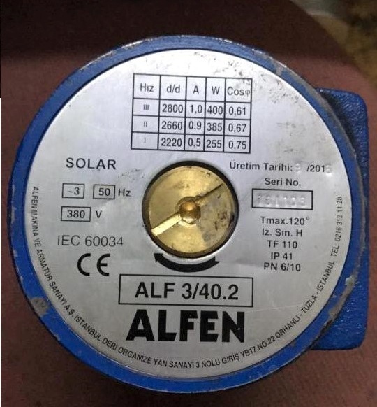

Hi, PaulLag,
I can not recommend a particular book that will answer your specific question, because this is part of the basic theory of electrical machines.
Try to find something about the power, torque and slip depending on various types of loads (constant torque vs constant power and specially variable torque application).
LionelHutz:
Everything I wrote in the last post refers to the three-phase fan motors. And not just to fan motors.
The same principle is widely used as a three-speed, three-phase winding of circulating heating pumps.
Note, this is the same kind of load.
This is achieved by adding the turns ( less or more) in each phase winding for middle and low speed, which is equivalent to voltage reducing.
Otherwise, how could you explain this case of three-speed motor ( see the nameplate photo below)?
Obviously, it is 2 pole, 50 Hz, three-phase winding for each of three speeds.
The number of poles and frequency is the same for each speed, but the slip is not.
As you can see Amps decreases with adding the turns ( ie. reducing the volts per turn).
More at:
Overhaul-of-heating-pumps
RE: fan speed and Voltage
Quote (zlatkodo)
Very simply, if the motor speed can be significantly varied by varying the voltage then it's a specially designed motor, PERIOD!
Voltage reduction for speed control DOES NOT work on standard SQIM's. Claiming that since it works with a specially built motor that it'll work for any motor is idiotic. Claiming that the motor can be speed controlled via voltage just because the OP posted that it's a fan application is also idiotic.
Going back to the first post, I expect the delta and star connection mentioned ACTUALLY changes the poles of the motor because it's a 2-speed motor. BOTH a star-delta motor starter and a Dahlander motor use 3 contactors. If you didn't know what to look for then you wouldn't know the difference.
LionelHutz
There is no need for harsh words.
You better try to learn something that is obviously new for you . I would be glad if I inspired you to do that.
Or , you think you already know everything ?
The first question ( and my answer too) is related to three phase FAN motor.
Quote (PaulLag)
Why then a fan connected in delta and star connection has a different speed, even though it is the same fan and fed at the same frequency ?
An answer is so simple: because of change in slip caused by change of voltage, PERIOD.
Quote (LionelHutz)
There is no need for two speed Dahlander motor for mentioned application. This is a winding with one number of poles, designed for delta connection at rated voltage.
You do not have to agree with me, but I expect arguments, not any aggressive attitude.

Hello everybody
First I do apologize if my question was unclear so that I generated this discussion.
Just to put things straight my question was referring to electrical motors utilized in fans as for example
Link
(see the ac fans)
If you see AC fans can
- Be connected in delta and wye
- Can work at different tensions (ex 400/3/50 or 400/3/60 or 460/3/60)
in a second hand this enforces the topic for me to increase my knowledge on topic, so, many thanks SparWeb, I will certainly take into consideration these two literature references.
I would like to thank all for having shown me how deep and extended is the subject.
Once more, please accept my excuses if a non-precise question has generated this discussion.
PaulLag,
thank you for your explanation and the link.
Short conclusion:
- here it is not about Dahlander winding, at all, but about the motor that is connected to Y for low speed and D for high speed.
- Regarding the above-mentioned limitation to single-phase, FPIM (fractional power induction motors): you can find on the link above a list of manufacturer's voltage regulators for 3ph fan motors. Some among them are 40 Amps at 50 Hz (note that is not VFD, but only voltage regulator). It is hard to be a "fractional power home appliance"!!!!
