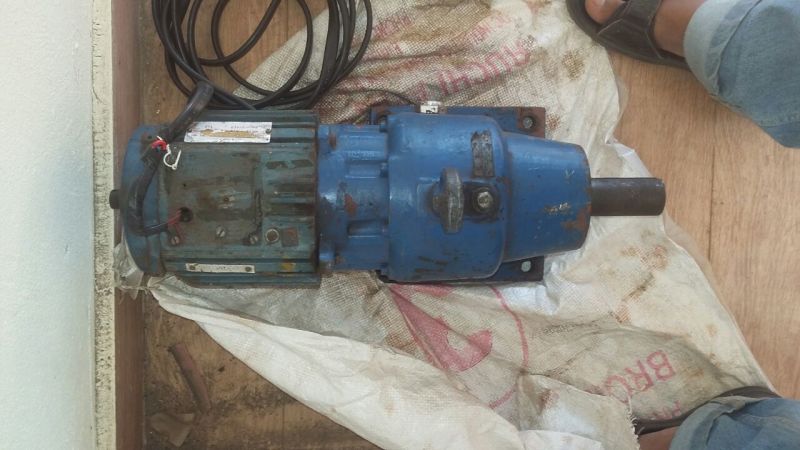

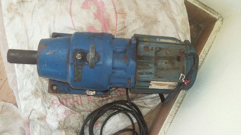

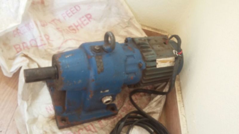

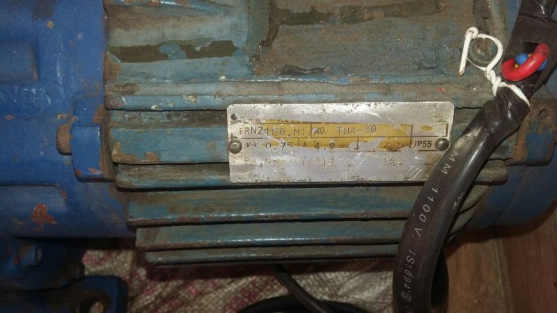

Here are the images of gear motor (1 hp, 40 rpm output, 3 phase), i want to use it for earth auger. for transmitting horizontal to vertical i tried with straight bevel gears but the cost of project increases.
Please comment on using gear-motor vertically.

RE: Guidance on Horizontal Footmount Gear Motor
Well, it presumably belongs to you and is paid for, so do with it as you wish.
You might consider linking it to the back of a truck or something, in such a way that you don't personally have to provide the counter-torque.
Not recommended.
That machine is designed for horizontal work.
Some gears may be lacking lubrication when working vertically.
Life of radial bearings will be shortened by the weight of the shaft and gears pushing down axially.
Since you have to feed the motor with 3-phase power and the torque will be hard or impossible to hold by hand, you will need some type of steel frame.
If that is true and you have the room to do it, crossed belts and two pulleys (one vertical and one horizontal) may be feasible.

Take the gearbox apart and make your own evaluation of whether or not the lubrication would be o.k. Maybe the bearings are sealed and don't require oil. Maybe you just need to add more oil.
Most, if not all, geared vertical spindle drilling machines have gearboxes that operate in the horizontal position.
The uppermost gears and bearings are generally not lubricated throughout the life of the machine as the oil simply doesn't get to those areas.
I've seen drills up to 3.5KW that are designed like this.
Perhaps grease is used when the drills are new.........and that's all that's required.
