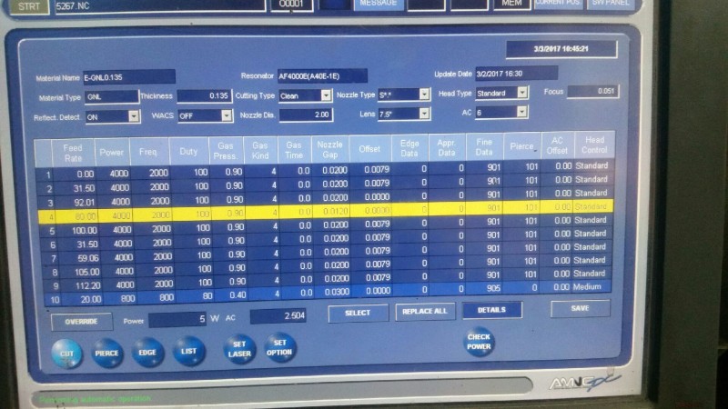

Hi all I cut is gal and been using MS condition settings using 7.5 lens and 1.7 nozzle with shop air or N2 any one cutting 10 gauge MS if so can you tell me what your settings are? Using a Mitsubishi 3015 no conditions in the machine for 10 gauge go everything else. been playing with the focus or gap and doesn't seem to be getting any ware THX

Thx hookie I will try that on Monday this will defiantly help .All I cut is galv. So just using mild steel setting then adjusting as I go. Right know cutting 14 gauge .at 2800 power 2000 FreQ 90 duty 200 in/min 12 gas pressure N2 gas -0.04 focuse 0.04 nozzle gap .will send you pic of screen on Monday Your screen little bit different thx again for the help .

Fabprohelp : I cut 16 GA Galvanized All the time with a 3015 Mitsubishi I will get you some pic of my screen tomarrow and I will get both with air and N2. Also galvanized will leave some dross underneath try to raise your focal point.
RE: Help cutting 10 gauge gal
Fabpro: I have to settings for you .This one is for N2 . 2700 watts 2500 frequency 99 duty 220 feed rate 0 offset 10 gas psi -0.04 focus 0.04 nzl gap. This for AIR 2700 watts 2500 frequency 99 duty 220feed rate 0 offset 6.5 gas psi 0.02 focus 0.04 nzlgap . This is using 7.5 lens with 1.7 nozzle.Two pics. Hope this helps.

Meps11, when you are saying gas pressure. Do you mean 10 PSI or 1.0 MPa? Because I cannot see how .06 MPa could possibly get through your material especially at 220 in/min

FABPRO: Sorry that was 10 MPa you can also use mild steel conditions. I run Mitsubishi 3015 EX-S series. SS conditions work but not good piercing time to long .But I still only use a 7.5 lens
Sorry I was away from my computer. I use the same setting for both 16ga ss and galv. But I run everything with a 7.5 lens. I can get a pic of the settings Monday. It's an fo 3015 so it should get a good reference point. If you want to email me just shoot it to andy@americanrampcompany.com
