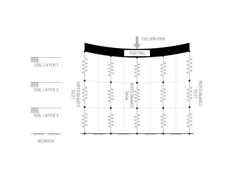

I have been trying incorporate some of the advice within this seminar (Link), but I am curious of any opinions (affirming or conflicting) with respect to mat foundations. It seems that the concern for varying spring stiffness isn't applicable when mat foundation span to depth ratios are low.

The half and double approach is a good first step. However, usually when engineers do this simplified bounding, they apply the scaling factor to all springs.
For large mat-slab foundations and heavy loads on a consolidating clay, you also need to vary the springs under the mat. That is, for long term behavior, the springs at the middle are weaker (lower k) than the springs near the edges. The foundation smiles, as you would expect, simply due to the variation in soil stress distribution ("Boussinesq" effect). If you ignore this (and many designers do), your reinforced concrete design will be unconservative.
Also note that the short term k of springs for wind and seismic (assuming that seismic softening is not a limit state) is much higher than the long term case.

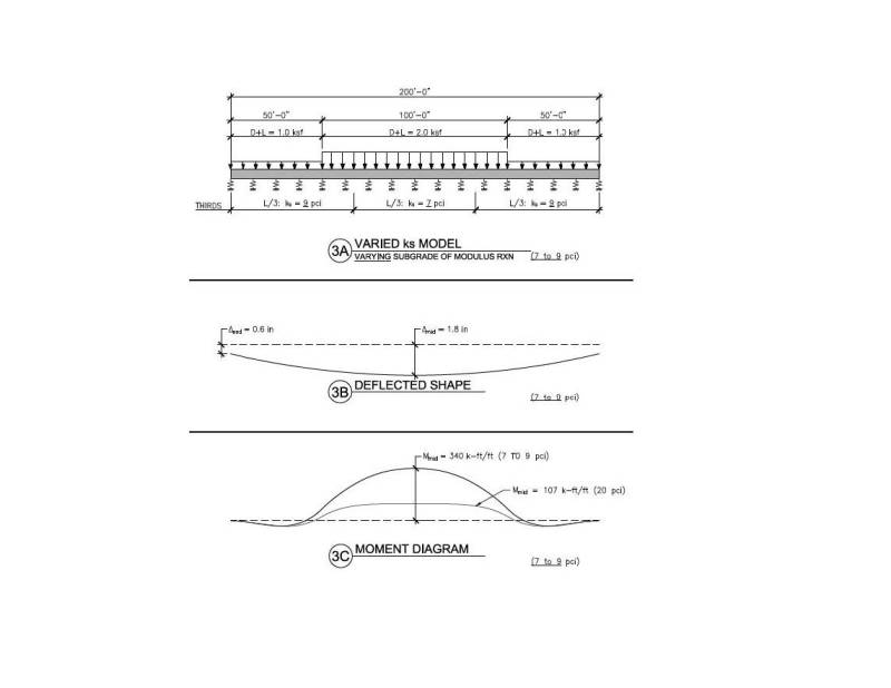

JAE:
I've seen your previous posts and you are obvious an experienced engineer. However, I would challene your last post. Thick is relative. I worked on a project with a 5ft thick mat. Looks really impressive on paper, and even more so in the field. However, it was 100ft long with a 12 story concrete building over it. It was actually very flexible. Aspect ratio (20), concentration of core walls, and cantilever end spans matter more than absolute thickness.
The spring constant values we use in a linear elastic analysis must be "fitted" to the actual or expected displacement. There is no engineering argument against this. We know large mats smile.
Figure 1 is conceptual. Figure 2 has numbers. Not a small discrepancy; the effect on both thickness and reinforcing is substantial.
This was done in RISA (cracked properties), backfitted to a Plaxis2D run. That is, adjusting the RISA k so the displacement pattern was similar. One iteration. Key input and results are shown. It can easily be checked by anyone. For simple problems, Plaxis is handy with nice color graphs, but not necessary. Hand calcs and influence factor estimations will get you close.
Because an engineer hasn't run thru the numbers on an unfamiliar method does not validate or invalidate the method. If we dismiss an idea or over-simplify, we should have a good engineering basis and some analysis results in hand. Otherwise, we are not unlike our contractor friends who tell us, "I built the last retaining wall half the reinforcing that you said it needed, and it hasn't fallen down yet."

RE: Use and Abuse of Soil Springs
MacG,
I suggest you design large mat foundations that are not sensitive to soil spring variations. You can easily be using a stiffness that is 200% too stiff. For spread ftgs or simple lightly loaded continuous footings, not so much a concern.
Of all the structural parameters structural engineers use for analysis, soil stiffness is the most variable (highest COV), and you have almost control over this, unless you switch to a deep foundation.
Stress influence can reach 2x the building footprint - many times this is deeper than the exploration depths.
If you've seen shear strength plots for concrete, they look like shotgun blasts. Think of the stiffness of a deep clay (varying moisture content, stress history, OCR...) more like a grenade.
ATSE – I’m not sure which “last post” you are referring to but I did say that “I suppose in some situations that may be the case”.
A 200 ft. long mat under a 12 story building could certainly be a case where a more precise analysis would be required.
Just to see for myself, though, I took your 200 ft. long mat loading diagram above and analyzed it in RISA. I assumed that your values are for a 1 ft. wide strip of mat – tell me if this is otherwise.
I used your variable soil stiffnesses (7 and 9 pci) and your loads – using Ig for a 1 ft. wide mat strip x 60” deep. (Ig = 216,000 in^4)
Note that the cracking moment for this mat is 285 ft-kips/ft. based on f’c = 4000 psi.
With full Ig for the mat and your 7 and 9 pci stiffnesses I got:
Max Defl = 1.87 inches
Max. M = 245 ft-kips/ft
Max Spring reaction = 24.8 kips/ft (over 12.5 ft)
Note that the mat doesn’t even crack here (245 < 285)
JAE - nice work. And in short order, no less.
I think we agree far more than we disagree.
In closing, I would make a comparison of results, using your numbers above (my numbers are close to yours).
Max M = 245 ft-kips/ft for the 7pci/9pci spring case
Max M = 83 ft-kips/ft for the 20pci uniform
Many SEs would consider the difference between the two spring stiffnesses inputs a nuance, but there is a 3x factor difference in resulting moments. Or, my experience is that they would not even consider a non-uniform spring value for the mat.
I would argue that if you got M = 83 ft-kips/ft and started your design effort, you would not be specifying a 5 ft thick mat, but instead something like 2.5 ft thick. So the reinforcing comparison, not to mention total concrete, would be more significant, since you would not be include As minimums in the comparison.
