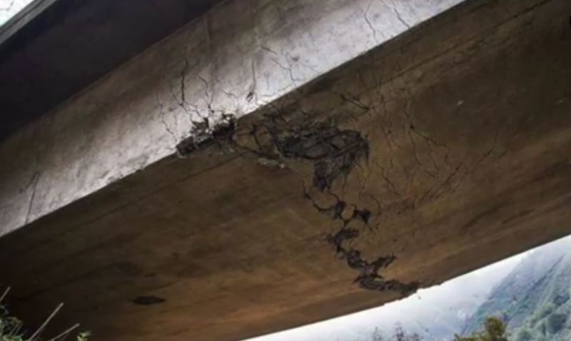

That section of California Highway 1 has experienced lots of problems. It is tough road building country.
RE: California Pfeiffer Canyon Bridge damaged by rains/earth
Aw... more hairline cracks...
Dik
Just guessing from the photos, but it looks like the base of that column has moved down the hill.
Yeah, and I swear I see curvature in the topmost foot or two of the column, suggesting that the base may have moved quite a lot.
The article JAE posted said it had shifted laterally. Looks like the connection to the superstructure is also torqued.
If I had bothered to read the article instead of just looking at the pictures, I would have seen the statement that "the base of the column moved downhill" due to the landslip.
Going to have to replace it.
From this view I'd have to agree.

Anyone know what type of foundation was used on the pier that slid down the hill?
Thanks Berkshire.... That 2nd article had much better pictures to show the extent of damage.
Wow! That shows a lot of vertical movement.
Yep. Definitely replace here - no patch and sack.
