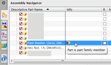

RE: How to check with a simple journal NX11 if the displayed part is a part family member ?
Where /what is the requirement ?
The simplest way of seeing if a component is a part family member, is :
Then , when i see the above, I RMB the component - Properties - Parameters - Part Family - Information.
Regards,
Tomas
